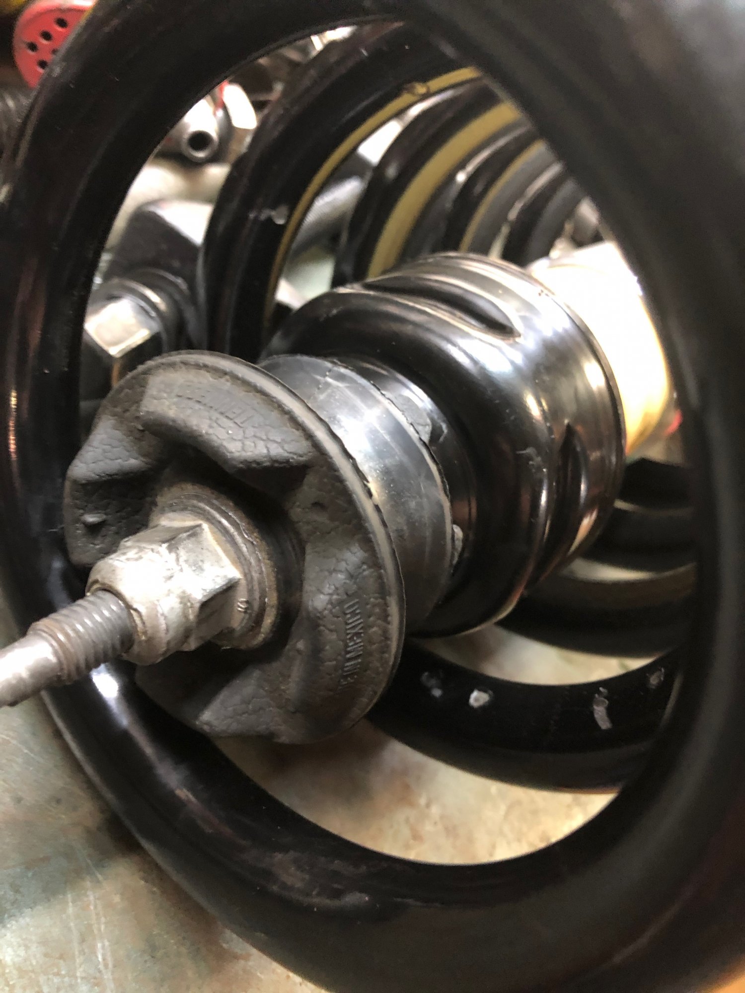

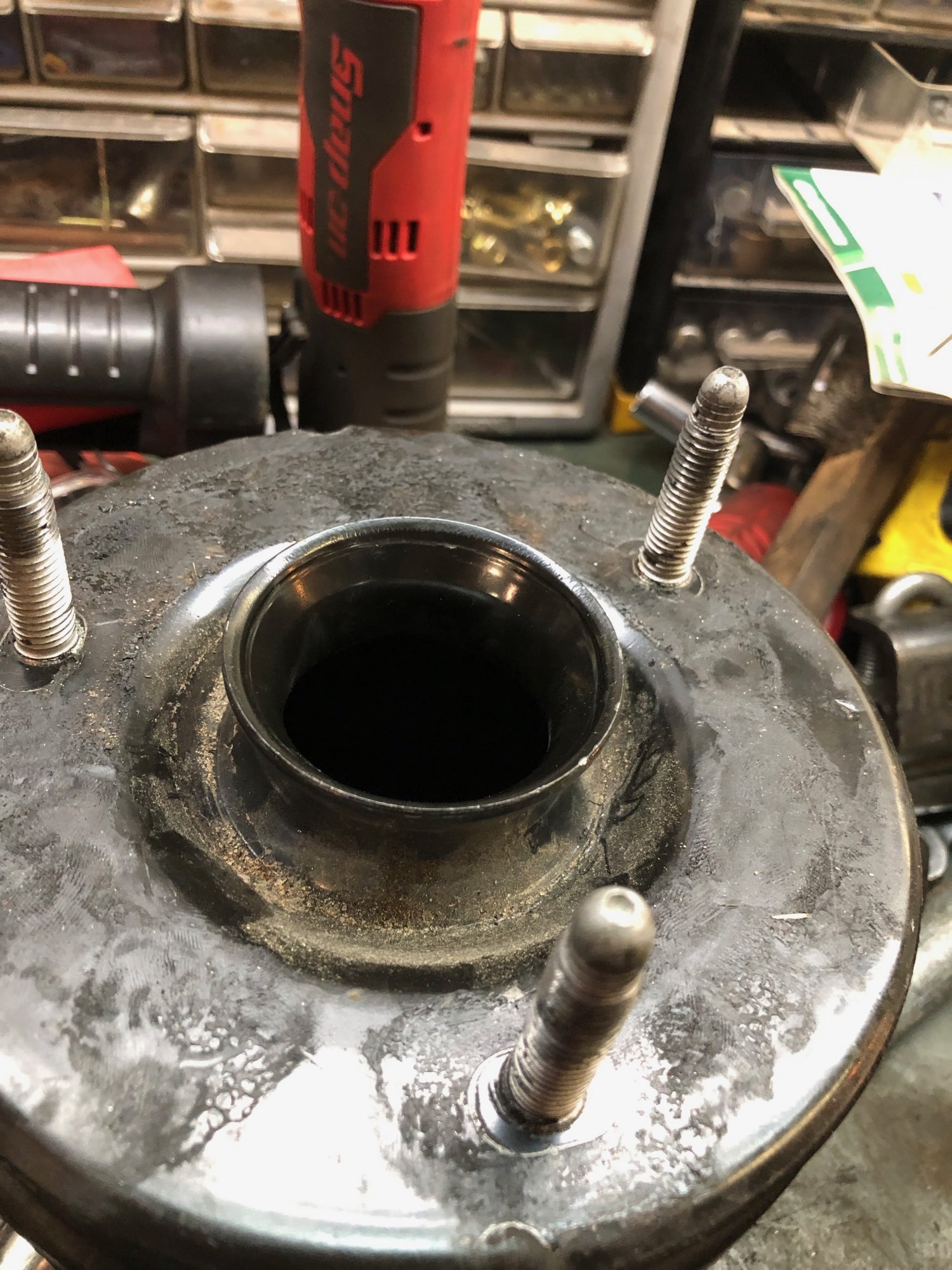

Was installing them on my 2018 last night, and it blew the top of the strut mount right out!  Had the top bolt secured and let the pressure off the spring and boom!  Luckily we were not in the line of fire although it was just a night for bad luck.  My buddy's wall mounted spring compressor broke on the removal of the stock one to get the mounting parts, and that spring went flying as well.  Once I get the new mounting plate, the stock ones are going back in.  Too paranoid it's going to blow out again although I haven't seen anyone with this same issue.
You just need new top mounting plates. We've seen this before on the forums. Using the old factory ones tend to give every now and then. Also this is why we suggest people not renting the AutoZone deals to compress the Springs as you seen the danger associated with compressing the Springs. Even a wall mount can give out. I wish this could be sticky for future reference and safety of others.
Only 8K miles on the original mounting plate, so it should not have failed?  Either way I'm just going back to the stock ones before my luck goes bad...
I had that happen and I just pressed the bushing into the plate using a large socket and vise. A little lube will make it easier too.  If I recall, I forgot to put the washer on top and that's why it popped lose.

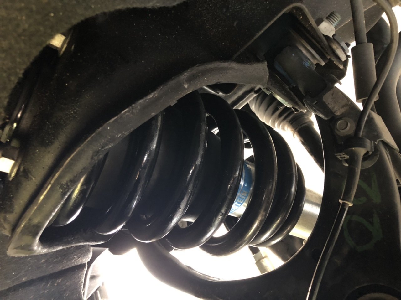

Stock height. A couple quick pictures attached.  Had to pull apart ball joint etc. and use a massive pry bar to get the A-arm low enough to get it up in there.
14 hours ago, Snowcamo said:
Nice! Hows the ride vs stock?
Slightly stiffer than stock on regular roads, but totally smooths out the bumps that were rough on the stock fronts.  It corners much better as well because there is less of a lean through the corner. I also have the 5100’s on the rear that I installed a few weeks ago. A couple of better pictures are attached.

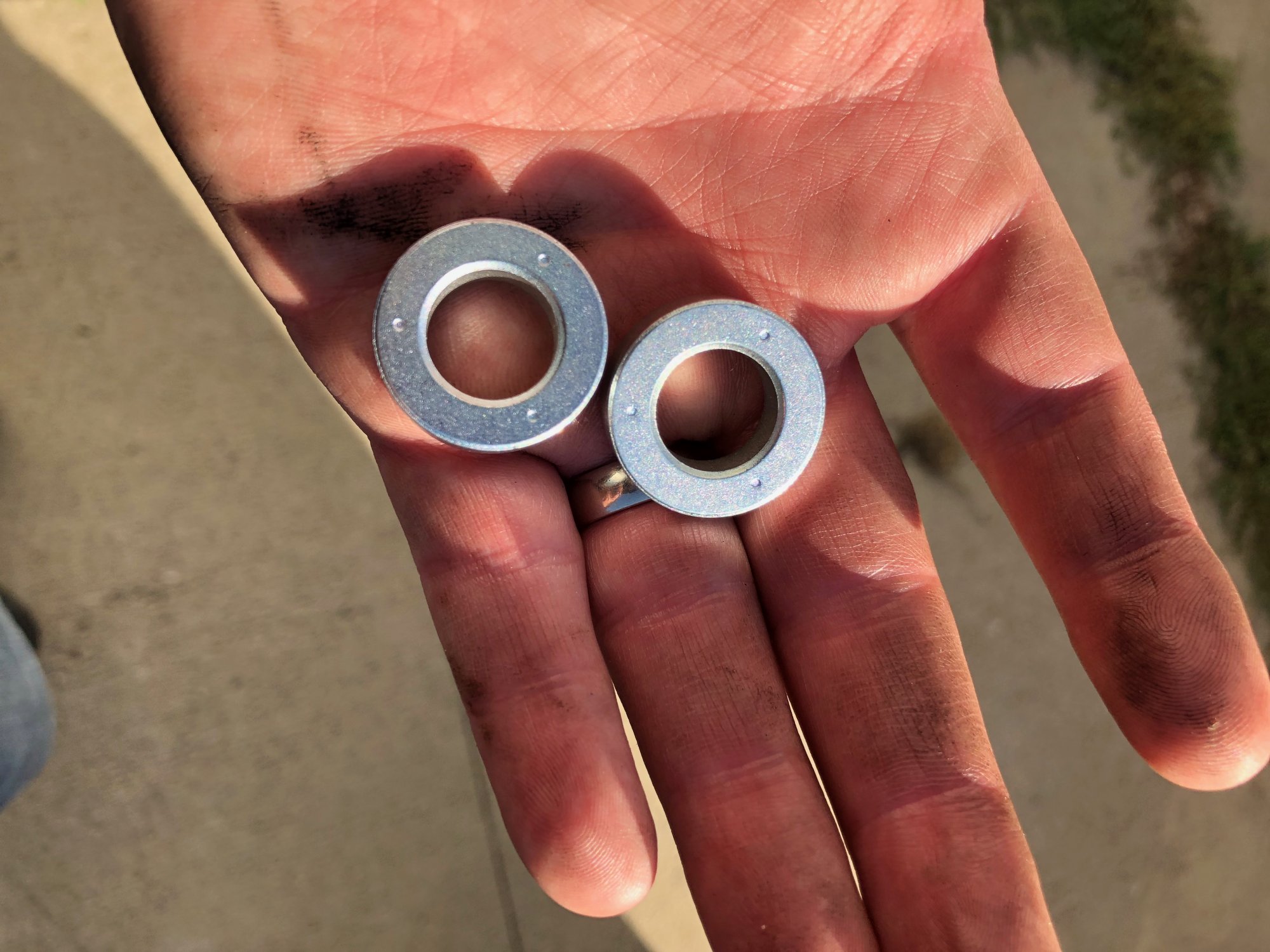

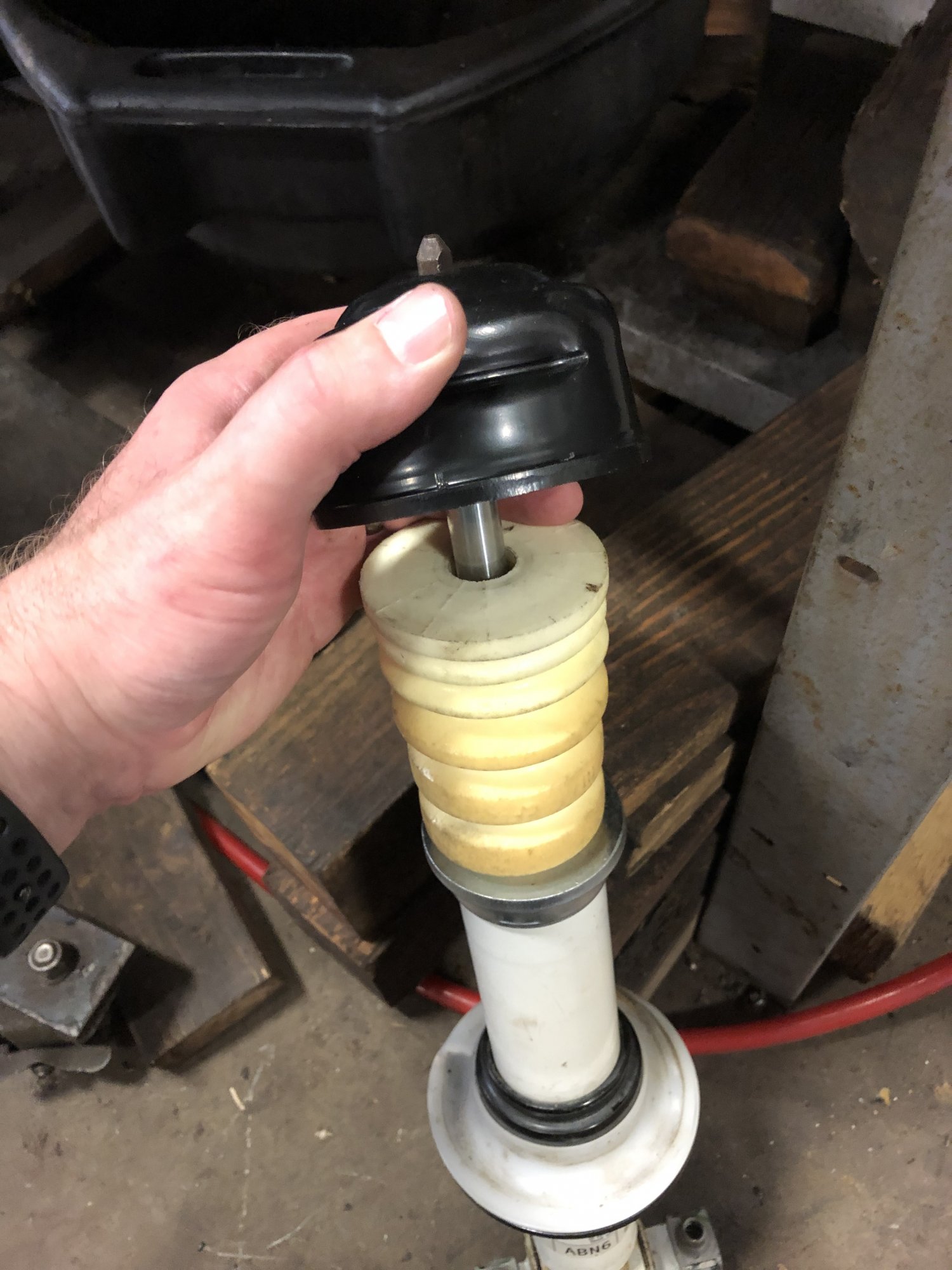

So when we pulled the first "old" one out, my buddy's wall mounted spring compressor broke and blew parts all over the place.  He's had it for about 25 years and a weld actually cracked and tweaked just enough to send everything flying.  We didn't realize that we were missing a top piece, and the washer (pic of the washer from both attached) on the inside of the setup so when we put the new one together it pulled the rubber grommet through.  Got a new top plate, figured out the 2 pieces we were missing and found them and then got everything put back together.  Luckily he had another friend with a shop and we used his spring compressor to get everything set up on the new ones.  Parts diagrams we were looking at didn't show the pieces we were missing, so we thought we had everything.  And yes, stock setup is Z71.
