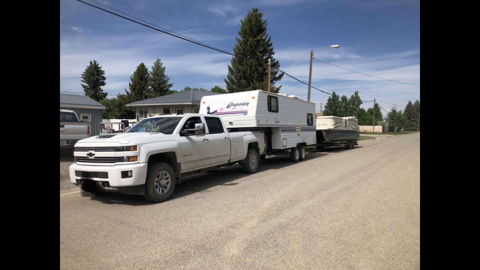

Ok sweet. And I’ll probably do the 6.2. If I wanted a diesel I’d stick with 3500. Any idea on what the max pin weight for an at4 would be? Here’s how she’s setup now. The pontoon was a buddies and obviously won’t be behind the camper and a half ton

Based on your tag and the picture, that is definitely a tiny 5th wheel.  But you're already at ~850 lb. for the pin weight which is 1/2 the payload of the LT Trail Boss above, and assuming that a 1500 6.2L AT4 is lower payload, you're starting to get into any trouble.  Trailer + 4 adults and you're maxed on payload right there.
