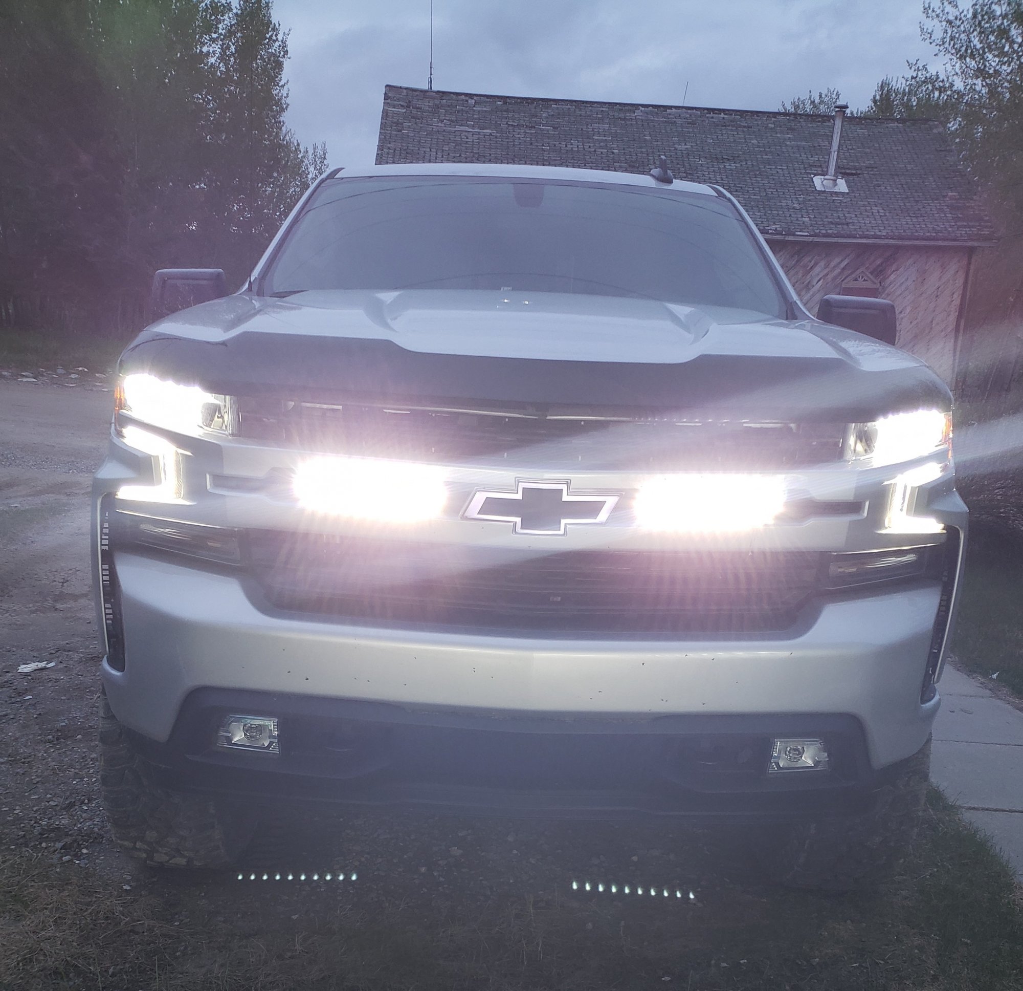

I just had them installed on my RST, they fit and look amazing. They are brighter than the headlights, but not crazy.

I installed the Rough Country lights, but tossed the wire harness and did my own thing, via GM Upfitter switches.  To be honest, these lights suck.  High beams are just as efficient.  The only benefit of this kit is the brackets.  I wish they were sold separately.  I plan on upgrading to Baja Designs 10" lights and using the Rough Country brackets.  I'll see if Baja Designs can make some S8s with Deutsche connectors.
