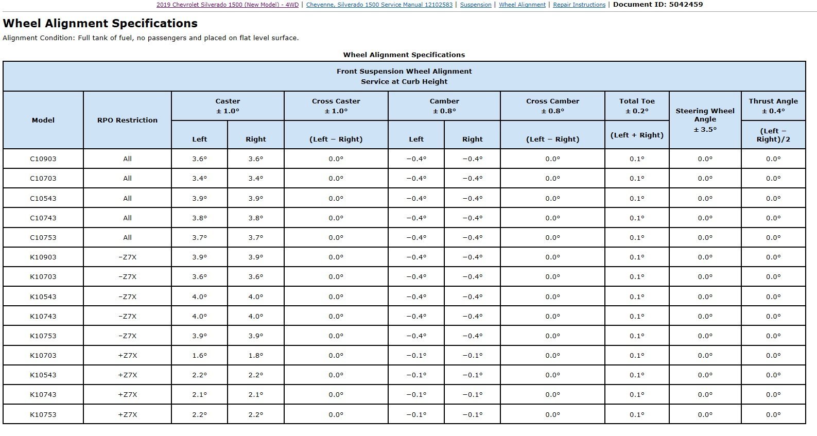

Can anyone tell me what alignment specs to use.  I found this sheet but it's all over the place.  I have a 2019 ltz max tow 4x4 crew cab 6.2.  Added 2" upper spacer in front.  1.5 block in rear.
Thanks
