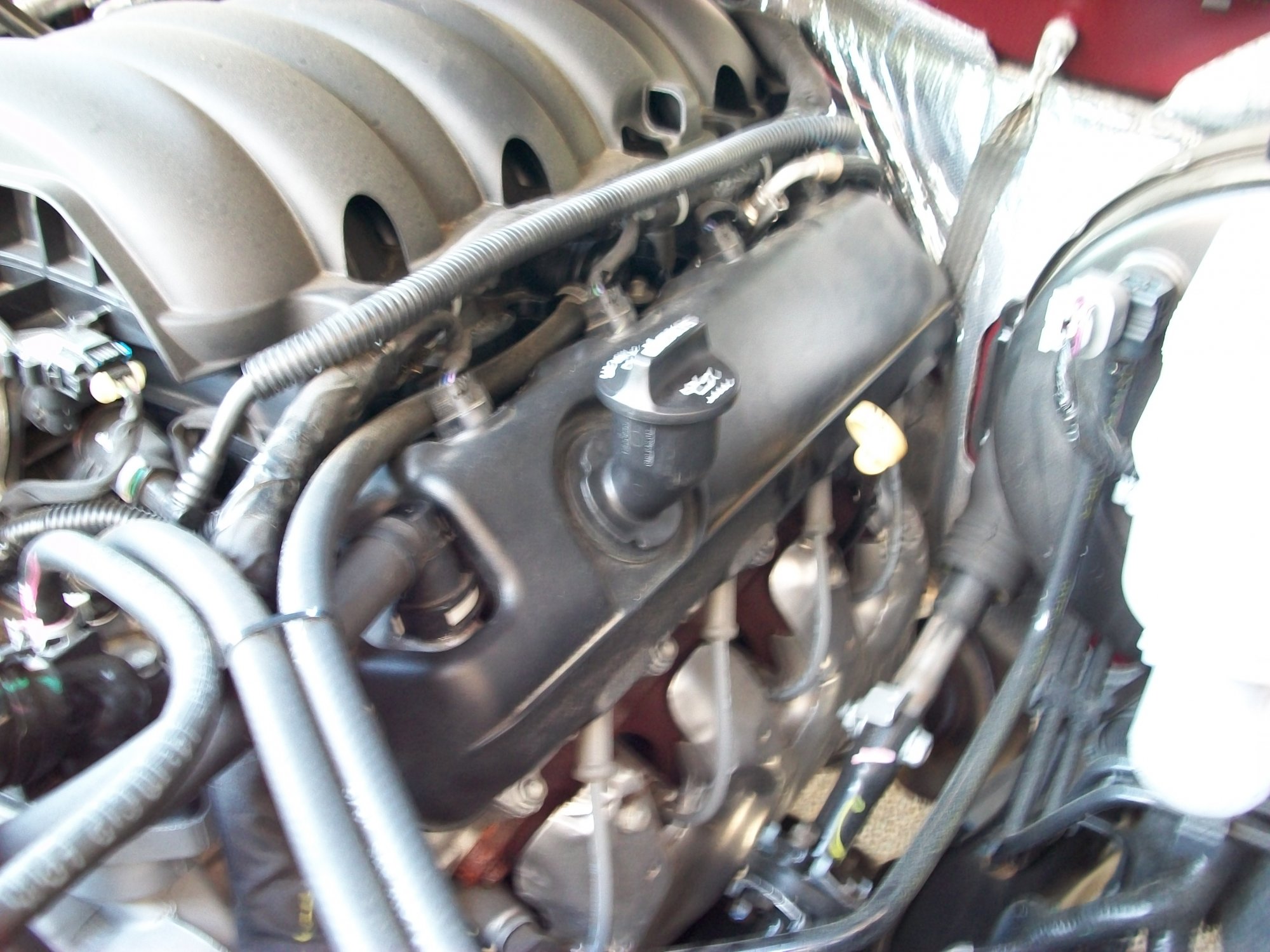

Here is my installation of a Dorman oil fill neck. I had to modify it with a Dremel and a shop knife. It seems to work pretty good for me so far. I don't have many miles on it yet however. I've not been driving my truck as my daily driver in quite some time so it sets quite a bit.
small.20190929_095908.jpg.6ced95659c509a
small.20190929_095709.jpg.f7628683165395
small.20190929_095604.jpg.b9f3a47c2e5fd3
  • 1 month later...
So I got the Dorman and modified it and installed works great. Only issue I have now is the factory cap the now goes on top of the Dorman neck fits tighter then the Dorman tube. So when I take the cap off to add oil the whole tube spins.
Any ideas to make the tube stop turning as easy so I can remove the cap only?
