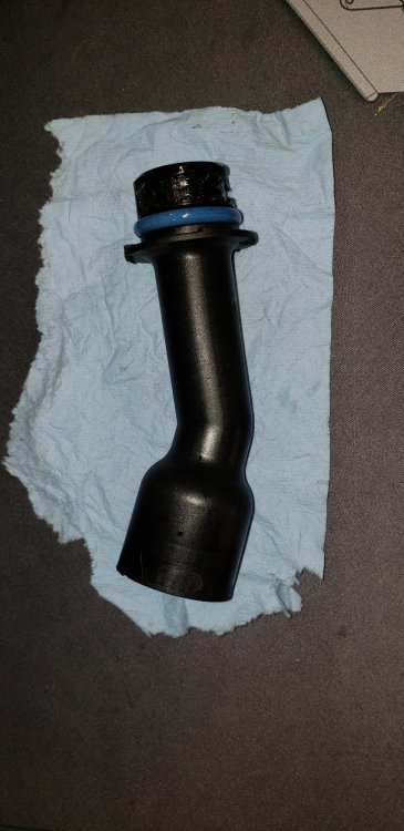

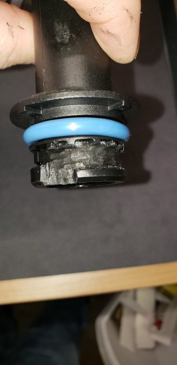

I did a similar mod on my 2018. I had a 2012 Suburban that had this fill tube extension, so I bought that part number and added it. It took some modifications because the 2012 version had a "detent" on only one side as it twisted on, and the 2018 caps have the detents on two sides. So, I Dremel-ed in a slot on the tube for these detents to ride. That made it fit. But, since it was not very precise in locking in, it wiggled a lot, and was hard to keep the tube in place, while trying to remove the cap, which fit tight. Given the catch can location on my 2018, it made removing the tube difficult because of its angles during rotation.
I sort of gave up for now. But here were my details and some pics:
Bought one of these - Dorman 917-412 (tall) or Chevrolet PerformanceOil Fill Tubes 12559505 (short)
Edited by ftwhite
