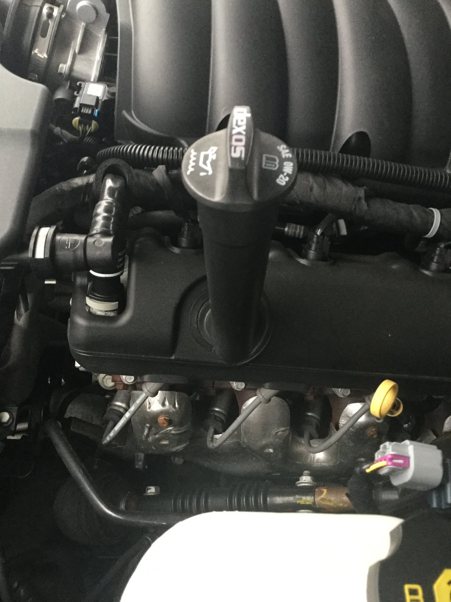

Got my hands on a 2019+ fill tube. Based on the fitting, looks like it will be damn near vertical after installation; maybe tilted just a hair forward. Will update photos after install

It verks...2A0C0961-B024-4A17-BA44-3F6183E2438A.thumb.jpeg.a268be4856282601bbf2068bfd31589d.jpegE321926C-2B51-4348-88E0-D28DF545C20A.thumb.jpeg.411fc8097a8d281af17e33ccea263aa5.jpeg
Can you give the part number for this?
Also, can you confirm that you didn't need to modify the locking grooves prior to installing?

Thanks for the confirmation, I just ordered one for my truck.  I did an oil change last weekend and it was a bit of a pain as my larger oil funnel was too large to fit in the hole, so I had use a smaller funnel.  It worked but I had to very slowly pour in the oil to keep it from overflowing in the funnel.  This should allow for much easier access next oil change.

Received mine yesterday and it works great.  Fits without any issue and is straight up and down on my truck.  Should make the next oil change go a lot smoother.

Did the cap off your truck fit, or did you need to get the newer cap as well?
I have a 2015 and the cap fits on the tube.
