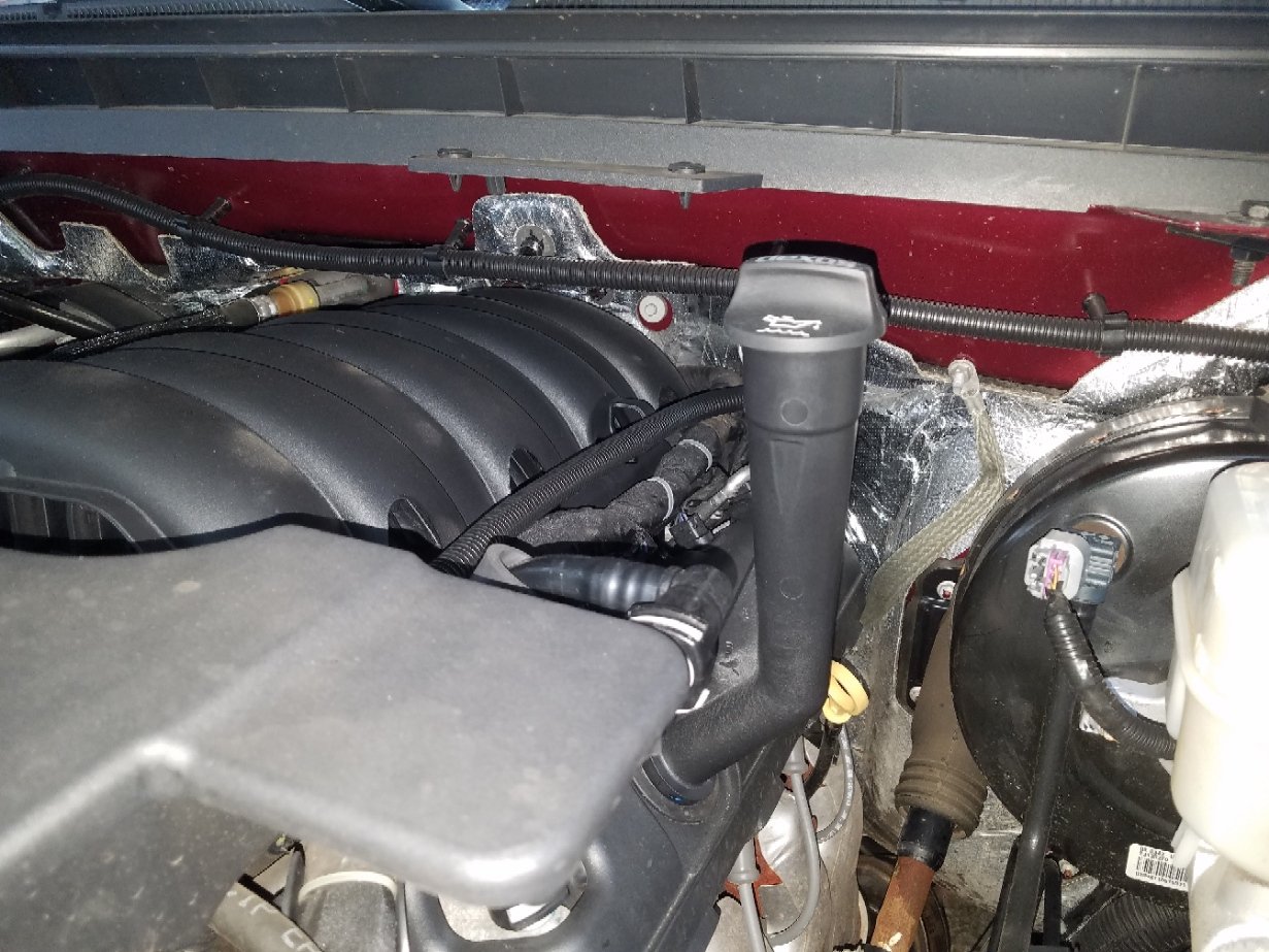

I thought I'd add to this thread, since I've been following it recently, and decided to purchase the "Newer 2019+" fill tube. I saw where the current cap opening would be an issue for adding oil. I ordered the Fill Tube here . It took about 3-4 weeks to get, so it may have been affected by the covid19 shut downs. Anyway, it came in & I installed it today. As mentioned before, it's not "stiff" tight in the existing opening and can be wiggled around. However, once in (it clicks to a snap lock" you can't get it back off or at least I didn't force it, as I didn't want to break it. The existing Cap fits fine, so I think all is well. Here's my pictures.

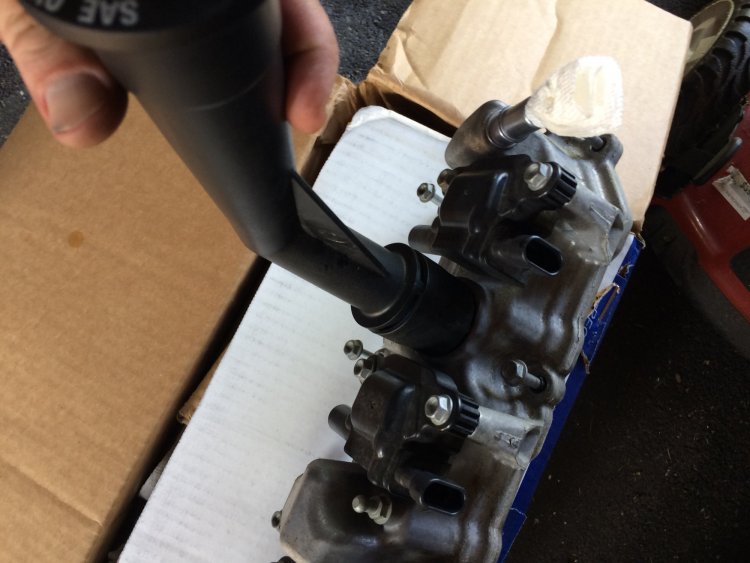

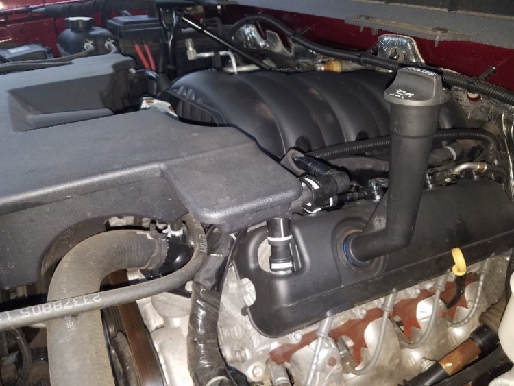

Originally, I came across this post about the newer filler tube fitting right on our trucks.  I ordered one since it was cheap and liked how it made adding oil easier but also wanted it for later adding a catch can and not fighting the hoses to get to the oil cap.  When I put mine on, it was a very loose fit and had me questioning if water and/or dirt could seep past the o-ring entering the engine.  I noticed that there is already a short plastic fill tube on our trucks.  The oil cap does not screw directly into the aluminum valve cover.  You can see the new tube screwed into the short original tube in my one picture above.  With the locking tabs on the fill tube(s) you can either twist them off till you break the tab and try to fish out the broken piece that falls into the rocker area, or remove the valve cover and use a small pick to release the tab.  After I got mine all apart, it is was a much tighter fit while screwing the long tube directly into the aluminum valve cover.  Doesn't move at all and seals nicely.  Since I struggled a little getting the original plastic coil cover off over the long tube, I ordered the 2019+ plastic cover as well.  Fits like a glove, and with the gusset on the long tube at the elbow, I'm pretty certain the original coil cover would not even fit with the new tube screwed directly into the valve cover.
Does that make any sense?  I'm trying to describe it well but feel like I'm rambling!  Compare my last picture to the others above. You can see how the fill tube is sitting lower and how it fits with the new plastic cover that is notched out instead of just a hole.
