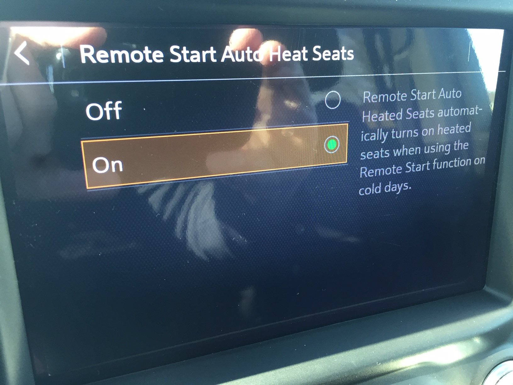

I seem to have zero heat coming from my 2019 Sierra SLT heated seats when I use the remote start.  Heated steering wheel is working fine, but not the seats.  Before I open the door, I have peeked inside to see if the heated seat LEDs are on, but they are not.  It's now 5 degrees here in MN and no heated seats.  My Silverado used to kick in at about 40 degrees.
See my pics below to see how I have things set up in the Infotainment menus.  Any idea what "cold days" is actually supposed to mean in the Infotainment message shown in the second pic?  When I call the dealership, they say the seats should kick in when it gets cold.  Yeah I get that, but what is the finite number of the temperature that is supposed to kick in the circuit?  Is the temp measured outside the cab or inside?
Here's how I have this feature (or lack of feature) set up.  See these two pics.  Your thoughts?  Thanks in advance for your help.

The heated seats will come on when temps are below 54 degrees with remote start. The one thing I noticed was that it’s only slightly warm. Not like they turn on high. So at like 50 I felt that the coldness was just taken out of the leather. Fast forward to temps in the low 20s. Don’t even feel like they are warm after 10 min of remote start. When I push button to turn them on normally they heat up fast and are hot. So they work. I was assuming they would be hot like running them on high during remote start. That’s not the case. Anyone have different feelings about it?

As others have noted, the intensity does not come on fully when you remote start.
If it's 15º outside, and your seat is 40º, that's a big difference.
Heck, it was 50º when I got into my truck this AM and that leather was COLD! (I didn't remote start). I cranked the seats up to 3 and started feeling the warmth in about 2 min.

My bad I guess.  I found out the seats are actually are coming on, but unless you wait about 10 minutes, you won't notice they are heating.  Factory setting to heat the seats when using remote start must be set to the absolute lowest amount of heat possible, so it takes quite a bit of time to heat up.
