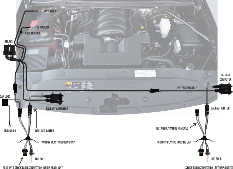

AlljackedupZ71 Posted December 20, 2019 Author Posted December 20, 2019 5 minutes ago, JLaw297 said: I had the same issue with my HID's as well initially. Added these PWM modules and boom fixed! Haven't had an issue in 4 years now. https://www.xenondepot.com/HID-PWM-Fix-p/pwm-fix.htm What brand HID kit did you have installed? The morimoto kit has the anti flicker capacitor... ignitors... then to the ballasts. Just weird how it was fine for all this time.. now this. Here is a lay out of the kit.

JLaw297 Posted December 20, 2019 Posted December 20, 2019 1 hour ago, AlljackedupZ71 said: What brand HID kit did you have installed? The morimoto kit has the anti flicker capacitor... ignitors... then to the ballasts. Just weird how it was fine for all this time.. now this. Here is a lay out of the kit. Most of my kit is from Xenondepot but with morimoto bulbs. It's been so long since I've last messed with them, but I want to say I installed them either between the bulb and the factory connector or between the ballast and the connector coming from the grommet/bulb. I can check this weekend. I feel your pain though... I went through the exact same issue switching ballast side to side, bulbs side to side and the problem never followed. They recommended those PWM modules and I've been good since!

JLaw297 Posted December 20, 2019 Posted December 20, 2019 10 minutes ago, AlljackedupZ71 said: Thanks! I will keep them in mind.. absolutely. Now that I think of it.. I want to say I installed them between the factory harness and the bulb connection and they just hang out inside the headlight housing. The factory harness is the portion that isn't giving constant power due to the PWM. By installing that between the factory connection and the bulb it helps "smooth out" the signal and keep constant power going to the bulb.
