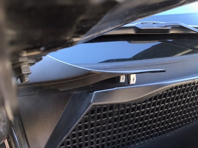

Past few generations this can be done.
Below steps are for 2019+
1. Unscrew antenna whip and then OPEN hood
2. Pull snap tabs on antenna/cowl cover from bottom first then the side.
3. Unbolt antenna base
4. Reattach antenna whip
5. Route antenna down fender and secure with a few zip ties
6. Get one of the round grommets from the bed
7. Trim the bottom rubber part of antenna cover area where antenna hole is with a razor on the bottom so the grommet attaches securely
8. Place grommet in the hole and snap cover back in from side first then bottom
It does result in a very very small reception loss but not much and I don’t use AM/FM radio a lot anyway.

9 minutes ago, mafd2 said:
Nice.  Is reception still the same with antenna being enclosed under all the metal?
90% the same but depends on where the local stations are in relation to you. Most did not change at all.
Beware on a Chevy!! Attempted today, does not receive any AM Stations, only FM comes in good. I reverted back to old antenna and will get a stubby so it does not hit my garage door when I enter. Also pictures on fender attachment are not the same on my 2019 Chevy LT new style, the different fender does not allow easy tie wrap attachment and antenna is too long to fit correctly
