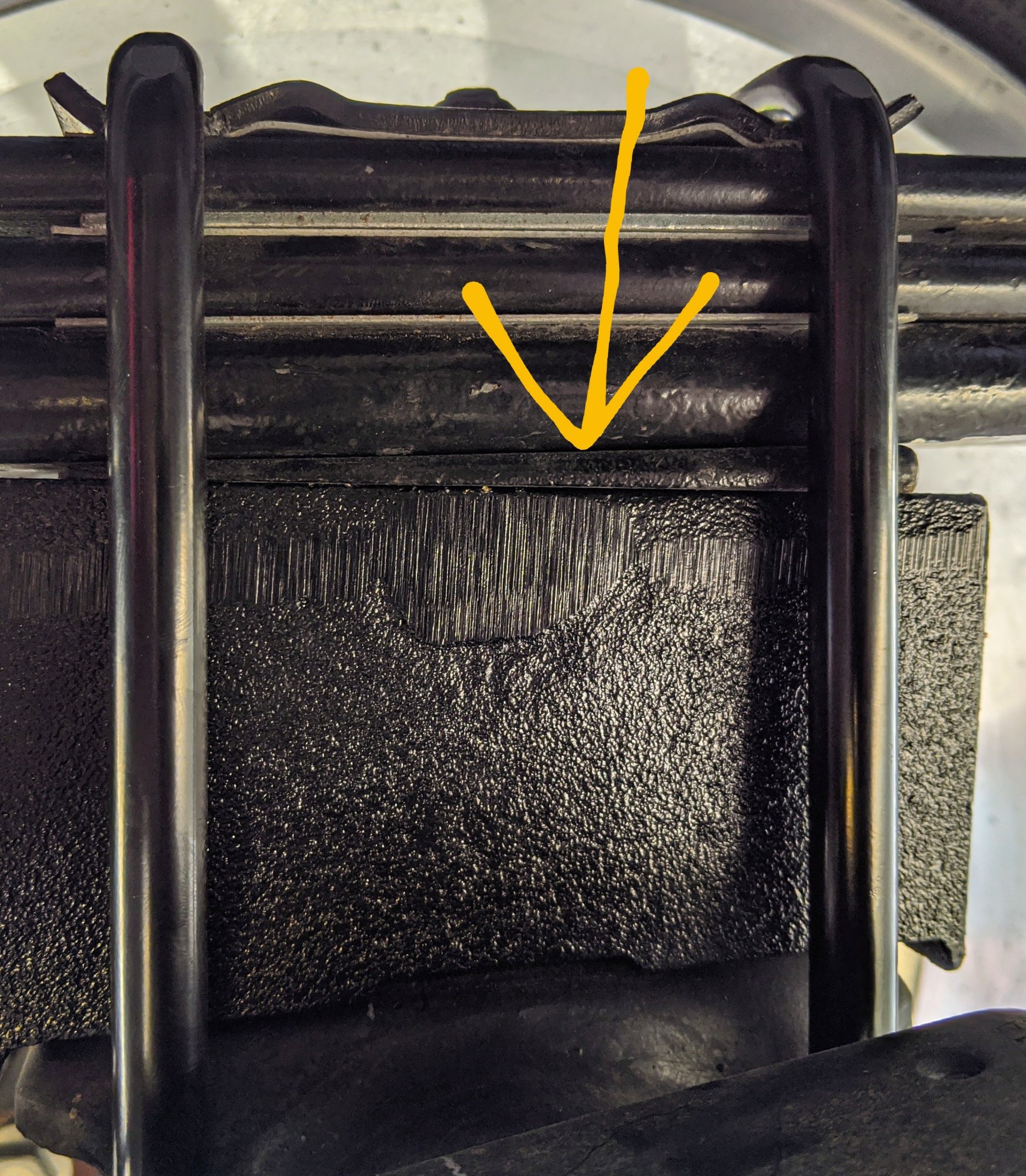

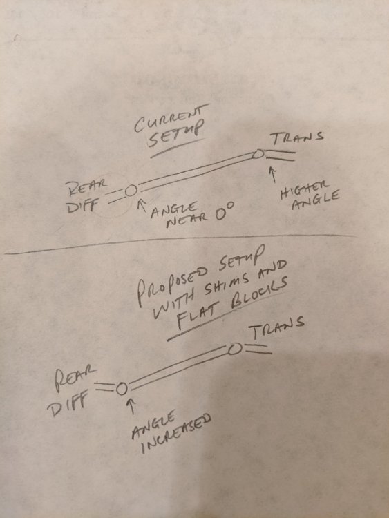

I want to get to the bottom of this once-and-for-all.  Those of you who have aftermarket lifts installed (with rear blocks), please indicate if you or your installer left the factory shims in place between the spring perch and leaf spring (the shims will now be on TOP of the aftermarket lift block - see pic).  My truck has less than 3000 miles on it and the ride was smooth as silk prior to installing the lift.  There is now a very slight rumbling/vibrating at 55-65mph.  ReadyLift says to remove the factory shim even though their instructions mention nothing of it and their own pictures in the instructions even show the shims left in place.  I've looked at other manufacturer's instructions - SuperLift says to remove the shims.  BDS, ProComp, etc. all specifically state to be sure NOT to remove the factory shims.  No rhyme or reason - some use tapered blocks, some use flat blocks.  My ReadyLift uses tapered blocks.
Now to complicate things further, a member here posted a pic of his 2020 and there are no factory shims installed on his truck.

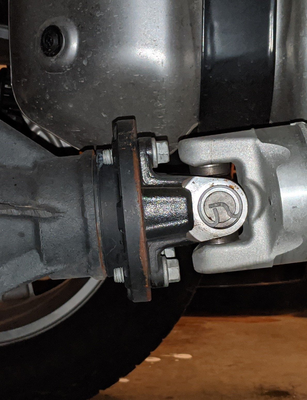

I am not against removing the shims - I guess I just want confirmation that is the problem.  You have to clamp the leafs together and remove the center pin bolt while holding it from spinning with ViseGrips.  Never done it, but doesn't sound terrible.  The angle of the driveshaft at the rear of the transmission is noticably "downward".  The angle of the driveshaft at the rear differential appears to be pretty much in line with the pinion.

The factory shims are installed with big end towards the front....so they are essentially cancelling out the taper of the blocks.
The vibration is definitely coming from the rear end.  I can almost hear it.  The front-end is smooth as silk....the steering wheel is nice and smooth too with no vibration.  The cv's are longer on the T1's than on the K2's and the front diff is narrower, allowing more lift capability.   There are several other members out there who have the 4" like me and report that their trucks are smooth so I don't know what's different about mine.  All of them have the factory shims still installed too.
All you need to do is get the pinion angle right. I would not continue to drive it like that. If it takes you removing the Shims so be it.

Then the ass-end would be 3" lower than the front.  I guess it "could" rule out the blocks, but the mis-match in height front-to-rear could induce other vibes.  The shims are attached to the spring pack via the centering pin so I have to disassemble that to get the shims out.
Long post, trying to help...I only said to remove the blocks to be 100% sure that's your problem. I understand it would be higher upfront. I didnt say leave it like that...a little cali lean..lol
Is the driveline high or low when u look at it..?  Measure the taper on the block, measure the taper on the shim.  U either have too much angle or not enough...so..
If the taper is more on the block than the shim I would pull the shims out and put the tapered blocks in. If not I would get a flat set of blocks and try those with the stock shim.  Or order a set of blocks from a company that said to remove em, or vise versa.

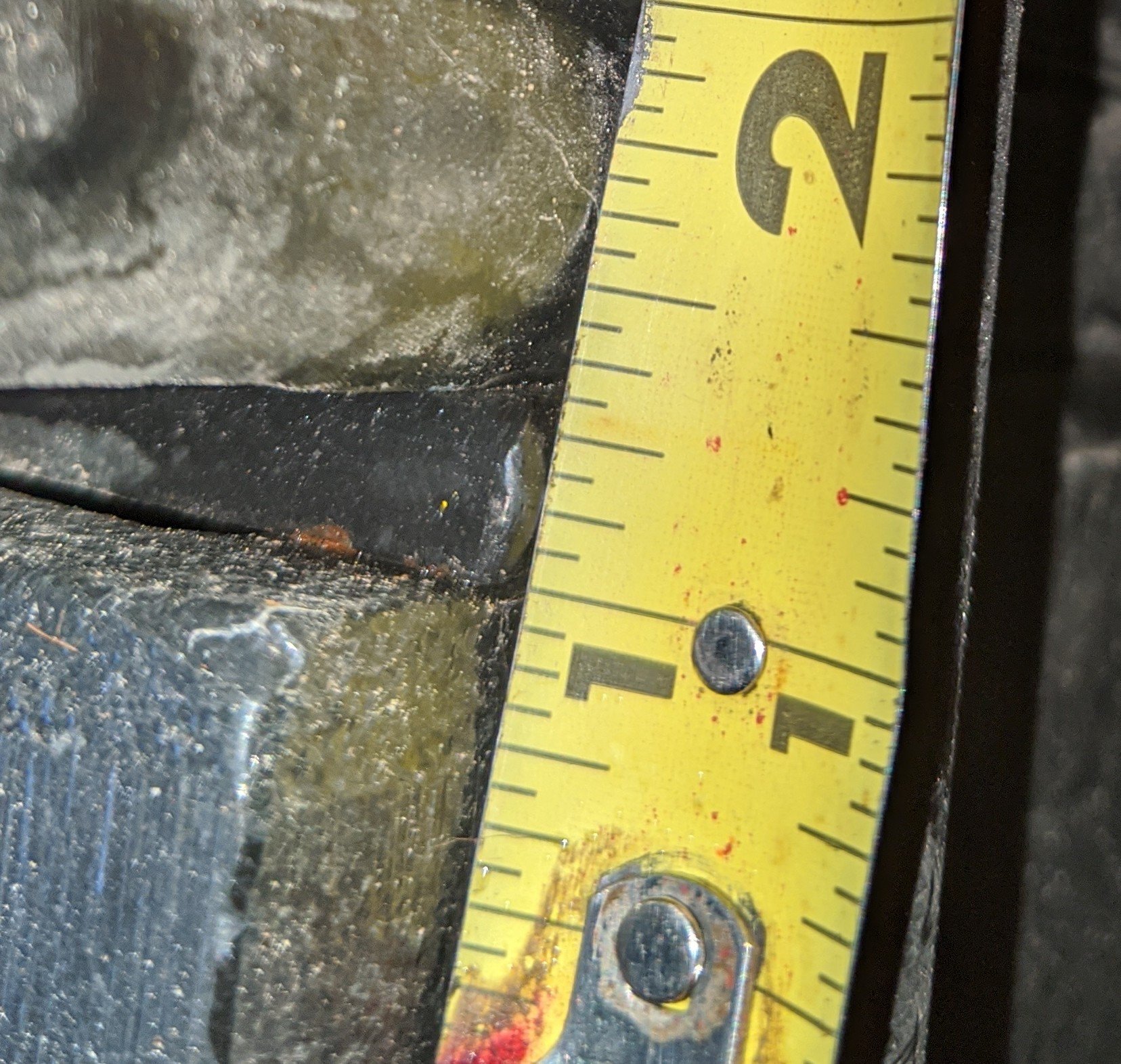

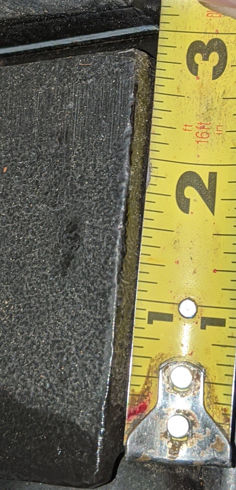

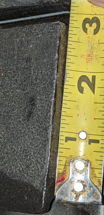

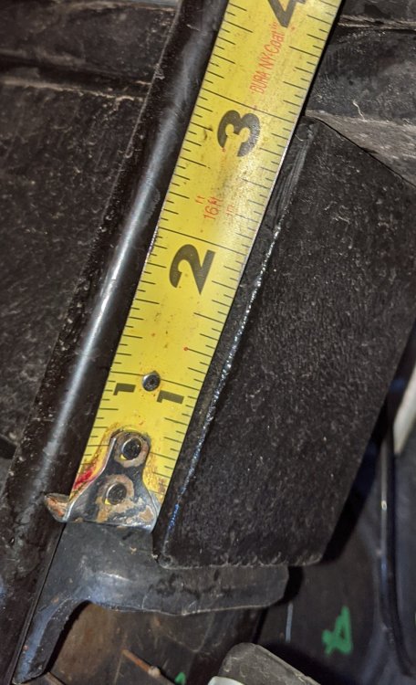

Ok, I just crawled under and measured.  The ReadyLift blocks are 3" tall at the back and 2-3/4" tall at the front.  The factory shim is 5/16" So, it is confirmed the angle in the ReadyLift block is cancelled by the thickness of the shim.  (Even makes the block TALLER in the front by 1/16" with it in there!).  The rear diff has an upward tilt and the angle with the driveshaft appears to be very close to 0 degrees.  Removing the shims will give the diff even more upward tilt.

Thanks.  After getting under there and measuring, this makes sense.  If I leave the ReadyLift tapered blocks and remove the shims, the diff pinion will be angled upward.  This definitely won't be "equal and opposite" the angle at transmission.  I'm thinking I need to leave the shims and just put in some flat blocks.  This will push the front of the diff down.
Edited by lapoolboy
Removing the shims and leaving tapered blocks will shift front of diff upwards and create funky angle that would be opposite direction of last one I show in proposed setup.
Think about that way the diff moves when you step on the gas, you want the pinion to be 1-2 degrees lower so that when u step on the gas the pinion goes up. So that's how it should be close to that. They make lots of shims to fix this problem.  Or are the blocks in the right direction..?? If it's too high now bring it down...
