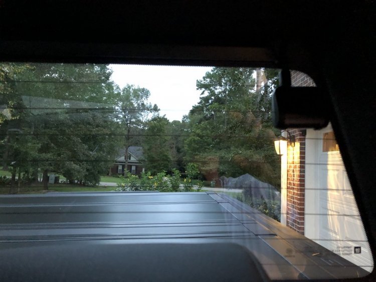

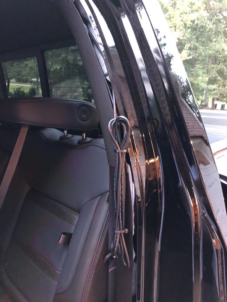

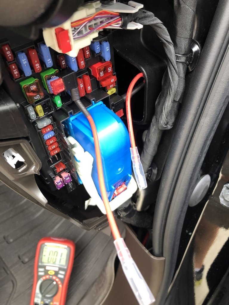

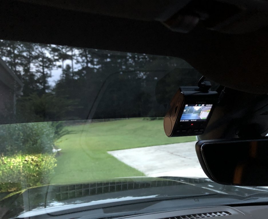

I installed the A129 Duo last year on a 2020 crew cab and it runs flawlessly. Parking mode works fine with the camera. No issues with any other vehicle components either. Most of the cabling was run up high in the vehicle.  The windshield camera was hardwired to the passenger side fuses. Continuous power, switched and a ground.
Power to the rear camera runs from the windshield camera to the driver’s side A-Pillar and then to the rear along the headliner behind the curtain airbags. The excess cable was zip tied tucked in the C-Pillar where it wouldn't rattle. Rear camera is on the driver’s side which captures a better view of vehicles in the opposite lane once they pass by me.
