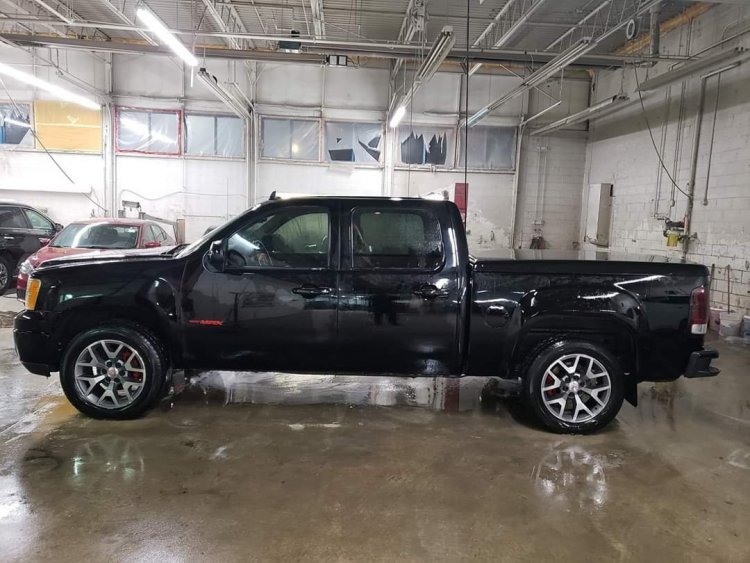

On 1/2/2020 at 5:18 PM, SteveCZ said:
Yeah..... that’s exactly why I got the 10.... so many problems with the 8.  I’m ready to go back to the 4 speed.....
you can have it for a nice price, facebook_1581265818915.thumb.jpg.2d72189fd430d24636aaad26f84de36c.jpg
