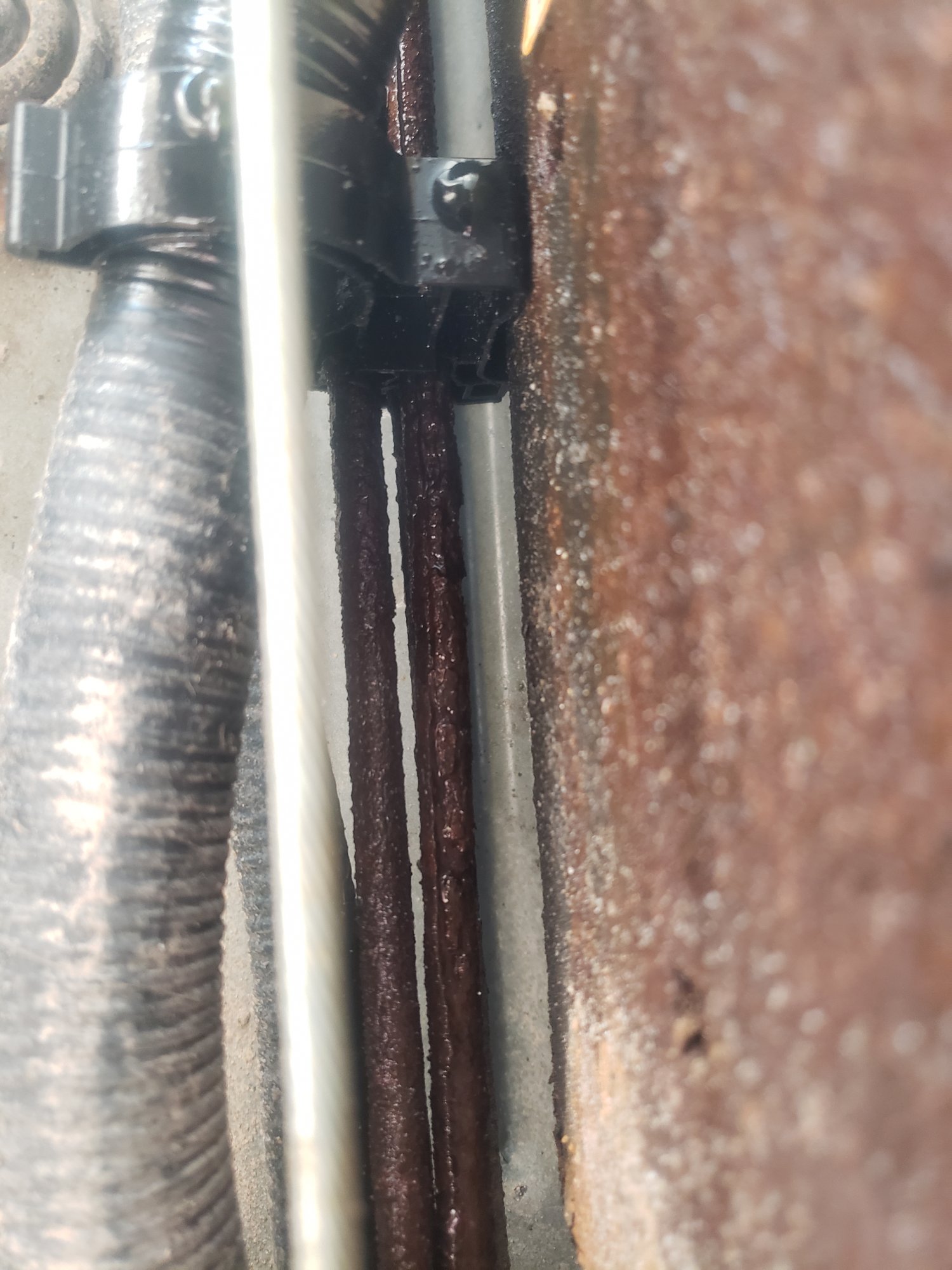

Well it's pretty clear in the daylight. Drove up to the truck and saw a big puddle underneath it which was weird because it's way below freezing. Master was empty and when I layed under it this is how the lines looked. Got stainless steel oe replacement line kit by doorman from advanced auto that I'll be throwing in hopefully soon.
Again thanks to yall for your help, I feel pretty stupid putting "doubt it's a fluid leak" in the title now... Oh well you live and you learn.

I had a feeling you'd find something leaking under there. Glad you found it.
