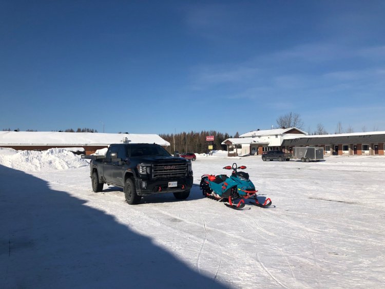

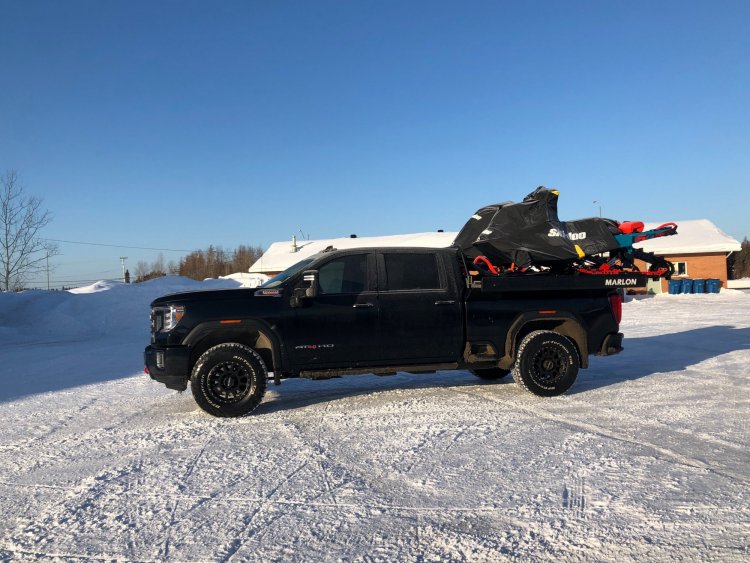

Basketcase Posted March 10, 2020 Posted March 10, 2020 I am running 18x9 +18 Method NVHDs with 35x12.5x18 BFG AT2s on stock suspension and no rub. 2
