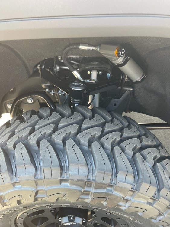

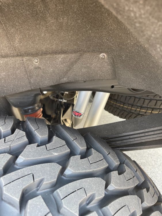

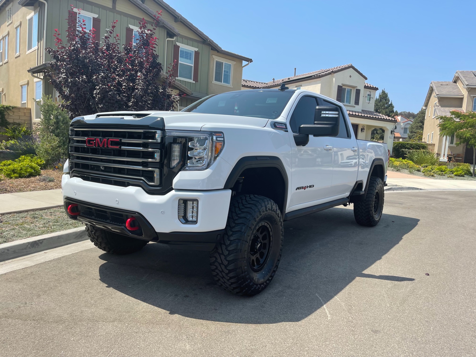

Finally received my long-awaited wheels and tires!  Installed the lift/wheels/tires and, after alignment and some minor trimming, here is the finished product:
image.png.a867ba0d3a4020f03b17f3b52b6ddb80.pngimage.png.c92d248ecf12a0e420e800adaa40e9a3.pngimage.png.0f24fd9e9e3338ed787b6fb48c777854.pngimage.png.1ab3122a2eee506fe254687e409c269e.pngimage.png.7ed0efeaa6ad89796a57d8563a776890.png
Details:
Zone Offroad 5" suspension lift
Fox 2.0 Shocks
Fuel Rogue wheels - 20x10 -18 offset (matte black)
Nitto Recon Grappler tires - 37x13.5R20
Initially the front tires rubbed on the factory mud guard, so I removed it and cut accordingly.  Reinstalled a shorter version of it and now...no rub at all.  The front tires also rubbed on the front plastic splitter (air dam).  Removed it and, after measuring, cut off the portion of plastic that was rubbing.  Reinstalled...no rubbing.  Can turn the front tires to full lock, left and right, with no barriers.
God...this thing is tall!!

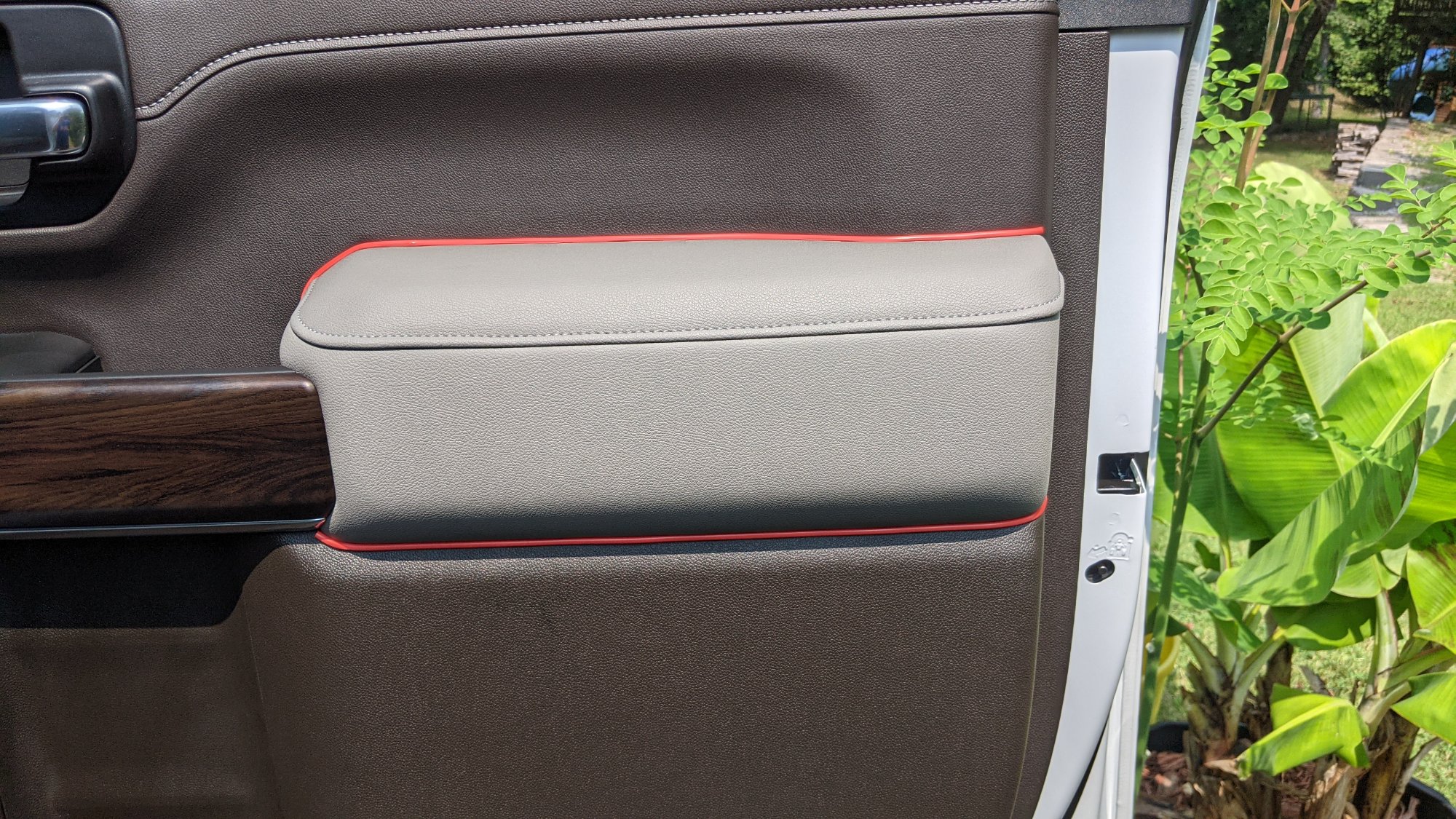

Added a little color contrast to the door panels. The picture does not show the true color which is orange. I had some piping leftover from doing my 1500 SLT. I may order some red and replace the orange.
That's a cool idea. May I ask what kind of piping you used and how to install it?

Looks Good
I just ordered upholstery piping (welting) for ebay. Install is very easy as it will press into the space between the 2 panels. Here is were I'll oder my next batch from. https://www.amazon.com/Bry-Tech-Marine1-Piping-Marine-Upholstery/dp/B07TWYH9ZG

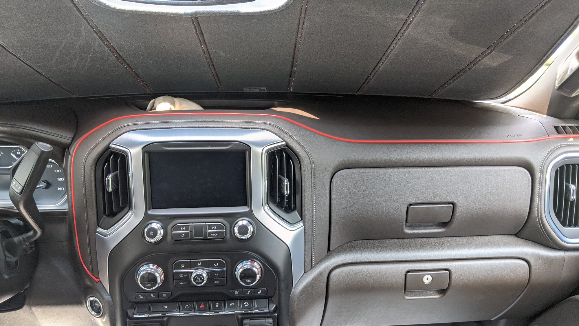

Finished the piping on the interior. Decided to stay with the orange. Did the dash and door panel arm rests.
