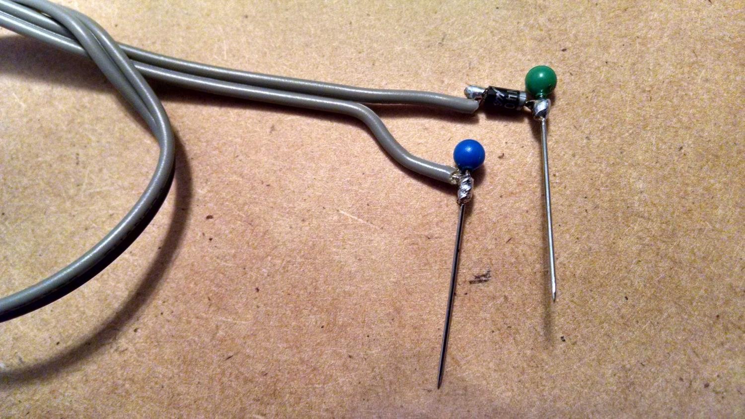

Using a couple of stick pins, some wire and a switch makes this mod a lot easier. The stick pins will slide in much easier than the leads on the diode. The switch (connected to the wire, and not seen in the picture) allows quick and easy deactivation of the mod for state inspection, etc.
