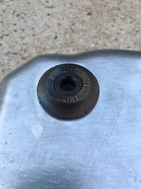

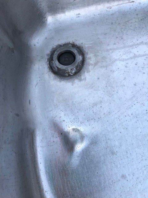

I just did our 2016 Suburban.  Dropped the pan, added a drain plug changed the filter and filled back up. I did this at 54k miles. I'll drain it and top back up at 100k since I'm using AMSOIL's ATL and from past experiences with it on my 2002 Silverado it has done an excellent job at keeping things clean and running smooth.
The drain plug I got from Summit Racing and I had a friend weld it into the pan.  Works great and no mess now when ever I have to drop the pan again.
