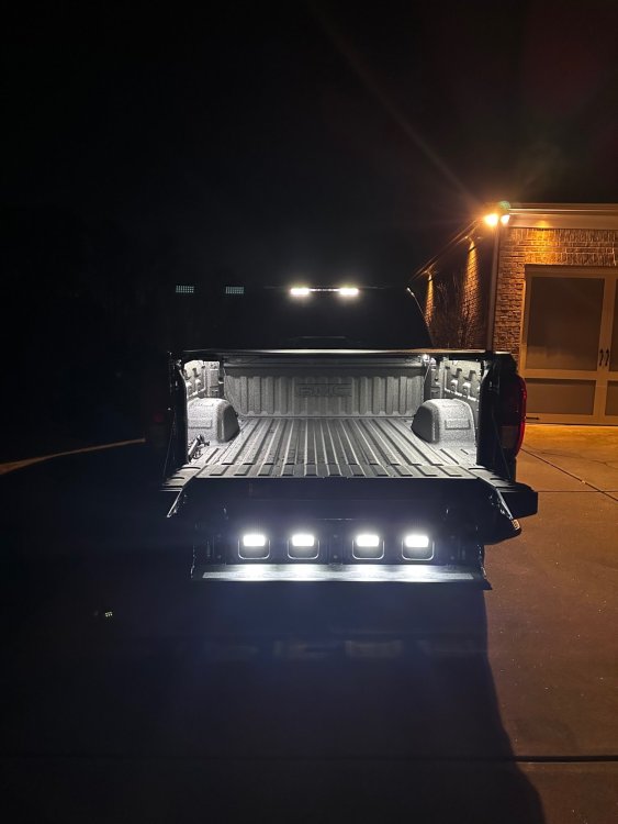

For some reason my LED bed lights that i installed flash every 5 or so seconds when my running lights are off (they are wired to be on when the running lights are on).
I wired them with a CURT 56584 wiring harness to avoid cutting or splicing any factory wiring harness and used the running light wire and ground to power the LED bed lights.
When I switch them on with the running lights on they also flash about 7 times then they finally power on normally.  Does anyone have an idea why they would flash?
Looks like the running light source has some monitor/power activity even when powered off.  Guess I will have to run power for the bed lights to the 7 way 12v constant and just remember to turn off the switch when not in use.  Either that or run them constant with a relay to the factory bed lights.

Thanks Ryno12 for the information I have never heard of this.  I just turned it off in the trailer settings and now the lights don't flicker or flash at all when off.  Either I got lucky or it was fixed with one of the recall/software updates.  Anyhow thanks again.

Well after turning off the trailer notification last night I got in the truck this morning and the screen showed lane change alert disabled and says I have trailer lights that are out.  I unhooked everything and finally got the truck to clear the errors.  Looks like I will go with the other plan to wire directly to 12V and not play with fire anymore.

I have a 2021 1500 sierra at4. Put a set of 3 led running lights on and tapped off the trailer running light wire. Well these new trucks are too smart. The truck can sense these lights and assumes a trailer is hooked up. From there, it thinks the other trailer lights are not working and warns you constantly. It also makes the side cameras come on when using the turn signals. I'm looking to see if hooking into the tail light parking lights might eliminate this issue.

Maybe I just got lucky but I just ran mine directly from each bed light and have had no issues. They just come on with the bed lights and go off with the bed lights. I used ttaps or whatever they are called and went straight to the bed light wires.
