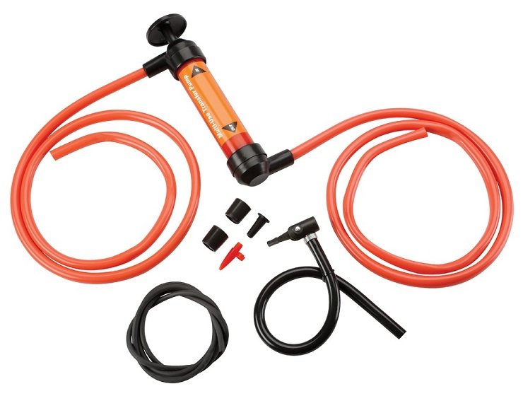

You can use one of these.  I have one and it works great for sucking out transmission fluid, power steering fluid and any other fluid other than fuel.

I've changed my transmission fluid by extracting it out of the dipstick tube (6 speed). I used this fluid extractor hand pump I purchased at Harbor Freight:
I had to use different tubing as the tubing that came with it was too limp to push down the dipstick tube. Purchased some standard clear vinyl tubing and adapted it to a piece of the included tubing. I think it was 3/16" ID, 5/16" OD. Once I got the tube shoved down as far as I could, I could pump out about 3.5 quarts. Whatever I took out, I would then replace with new fluid (MaxLife ATF). I would do this at least 3 times with some driving in between. Each time the fluid coming out would get a little more clear red. Here is a pic of the OEM fluid after the first exchange:
