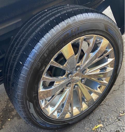

A little info about the setup, I had to set them up for a K2, so I went with a 285/45/22 tire, instead of the taller, slimmer, 275/50/22, that comes on the T1. Also I bought a set of new takeoff OEM GMC Accessory wheels and tires, off a 2020 GMC Terrain with blackout package, for my wife’s 2018 Equinox, and they came with Hankook tires, I liked those pretty well, so I went with a Hankook Dynapro HT tires. Then of course I had to use a K2 315mhz TPMS sensors instead of the new T1 433mhz sensors. Topped off with OEM chrome center caps & lugnuts.
