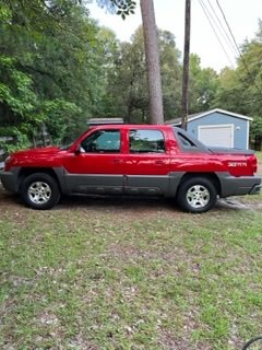

KARNUT Posted May 25, 2023 Author Posted May 25, 2023 (edited) Figured since I had a recent photo after I treated all the body armor. I post a picture. She’s been a gem. Driving it more often still amounts to about 18 miles a day. Had a little twinge of it’s time for something else. One ride in a knowing what you got ride quickly silent the thought. It was fun in the past when I was younger. After so many it’s been gently driven lies, this one is staying. Edited May 25, 2023 by KARNUT 1
