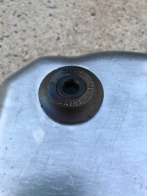

Here is the drain plug I installed on our 2016 Suburban.
Wow, that's nice work, did you weld that in?
Yes, welded it in and the clearance inside the pan is minimal.  No issues with it touching the transmission.
