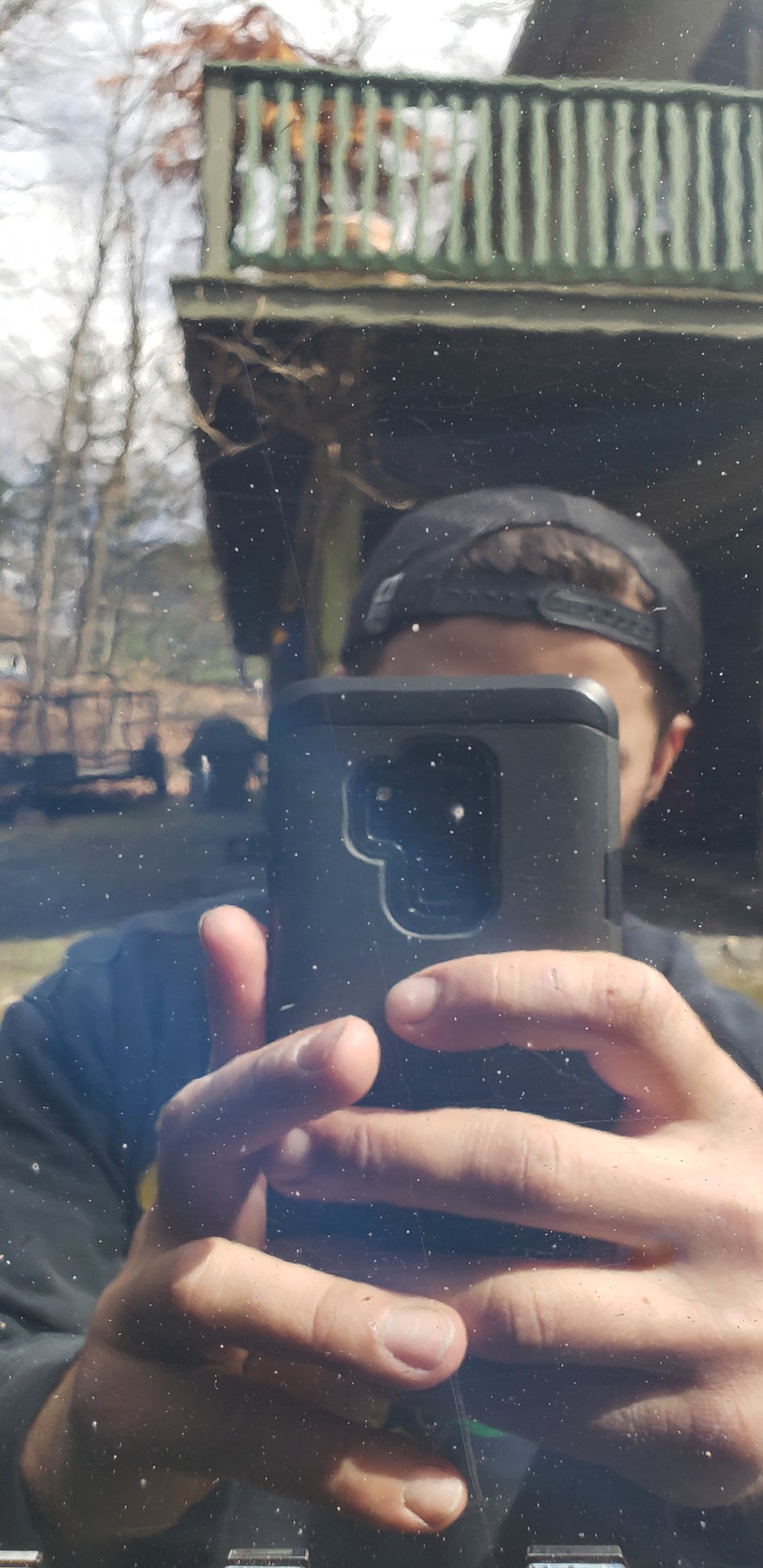

I have a black 2018 silverado 1500 LTZ.
Only has about 18k miles on it.
There are tons of tiny rust bubbles come through all over the truck!!! It is a lease and its still under warranty. This we be covered I assume??

Any grinding or metal work been done around your truck? I've seen paint like that when someone threw sparks all over it and the tiny metal pieces were allowed to sit on the paint.
Could be rail dust too.
Grab a clay bar and see if they will come off with that. Spray it down with detailer cleaner, clay bar the area and wipe away to see what you get.

That's what it is . My black 2018 had this all over the bottom half of the truck. When I got it ceramic coated it took the guy an absurd amount of time to get it off.
The dealer won't touch it .
Normal not a mfg defect

Buy some car detailing supplies (clay bar, iron remover, paint protection of your liking).
Spend a day get it looking good
Ryan B.
Iron remover first though. Clay may pull out tiny pieces and scratch the paint.

For sure on the iron remover.
I'd try this stuff. Then clay bar. Then polish. Then wax it or use a sealer like  Meguiars 2.0.

Yup not rust just contamination on the paint. Wash it then clay it with tons of clay lube then wax.
