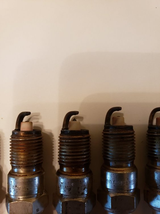

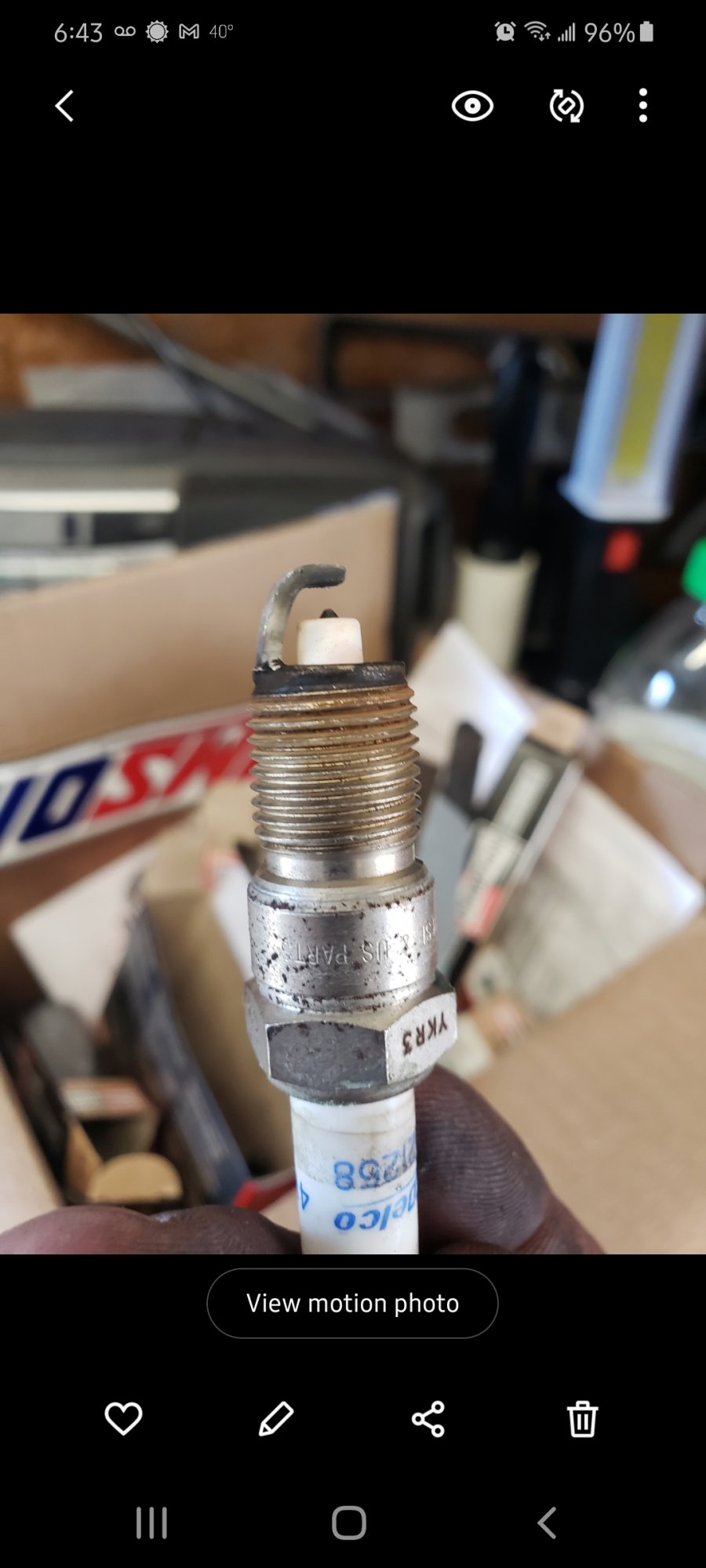

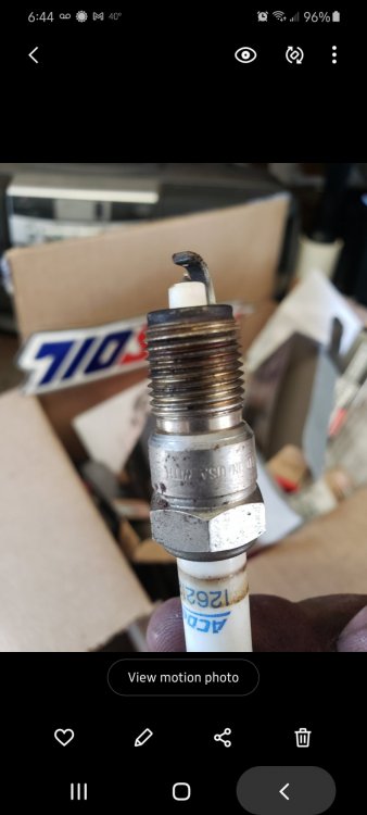

Hey guys. Out of curiosity the other day, I replaced the plugs on my 2015 6.0. It seemed like the truck would slightly misfire on a cold start for a few seconds and then clear up, hence my curiosity. Truck has 47,300 miles on it at the moment. I found that 4 out of the 8 plugs i pulled had the electrodes burned off.
Any reasons you can think of why this would happen? I live in Wisconsin and it does sit outside in the winter time without a block heater, so the only thing i can think of is excessive idle time.

I only tend to see copper plugs and maybe nickel plugs do it that bad. I always run Iridium plugs in these trucks.
These are the OE Delco 41-110 plugs that were in the truck since new, and as far as I know they are Iridium plugs. I was just a little shocked to see something like that with low miles.
Maybe check the fuel trims?  If the engine is running lean for whatever reason, it burns hotter, which would result in the plugs burning like that.
Note, the fuel trims reading may say the engine is running rich (ie, the O2 sensors read too much fuel, so the pcm orders less fuel injected into the motor).
I unknowingly installed counterfeit AC Delco plugs in my truck (purchased from Amazon) and in less than 5k miles they looked like that. I know you say they are original (and with that mileage it makes sense) but damn there would have to be something wrong with your truck to eat them that fast if they weren't a cheapo/ fake plug.
3 of the plugs came out of the driver's side bank (CYL 1,3,5) and the last came out of the passenger side bank (CYL 6).

Those plugs don't normally look like that after 50k.  Something did that, either they were defective/knockoff (unlikely as it sounds like they were original) plugs, or the engine is running too hot, or something weird is happening with spark generation, or perhaps somethings up with the fuel.  And I would also go with the idea that whatever the problem is, burning up the spark plugs isn't the only things being damaged...
How many hours are on the truck? It does seem you have some underlying cause creating this.....
