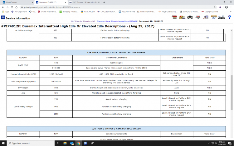

They can run high idle at startup, sorta like automatic choke on an old gasser.
And they can run higher for a reason like electical load, coolant temp and so on.
They also will run higher shift points when cold.
My response was interpreting the op's description as never returning to a low idle once fully warmed to normal.
It will also run higher idle when Regen is active iirc on mine it is right around 800-900 rpm .  Make sure it completed a Regen.
Yes, idle never returns to baseline. This is not a "variable" idle rpm. It is over 800rpm all the time. Except at start up when it will idle at nase rpm  ut as soon as I drive off and stop the first time, it is above 800rpm and does not ho down until I shut down the engine

6 hours ago, white94rx said:
Your truck is in the middle of a regen. Drive it longer and when it's done the idle will go back to normal.
