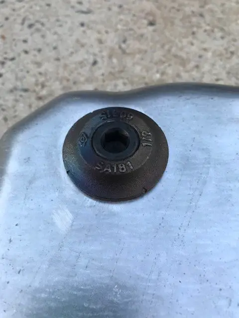

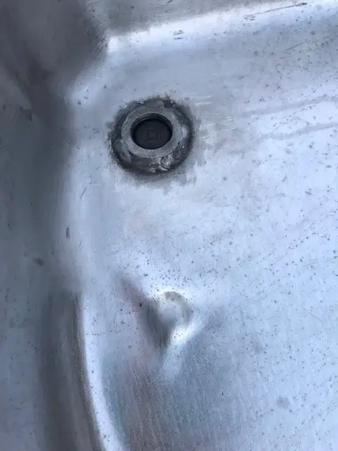

I had our 2016 Suburban changed out completely shortly after we purchased it with AMSOIL's ATL.  I did a pan drop at 50k and added a drain plug to the pan that I got from Summit Racing.  So now I can just drain and fill when ever I want with no mess of sucking out the dipstick.
