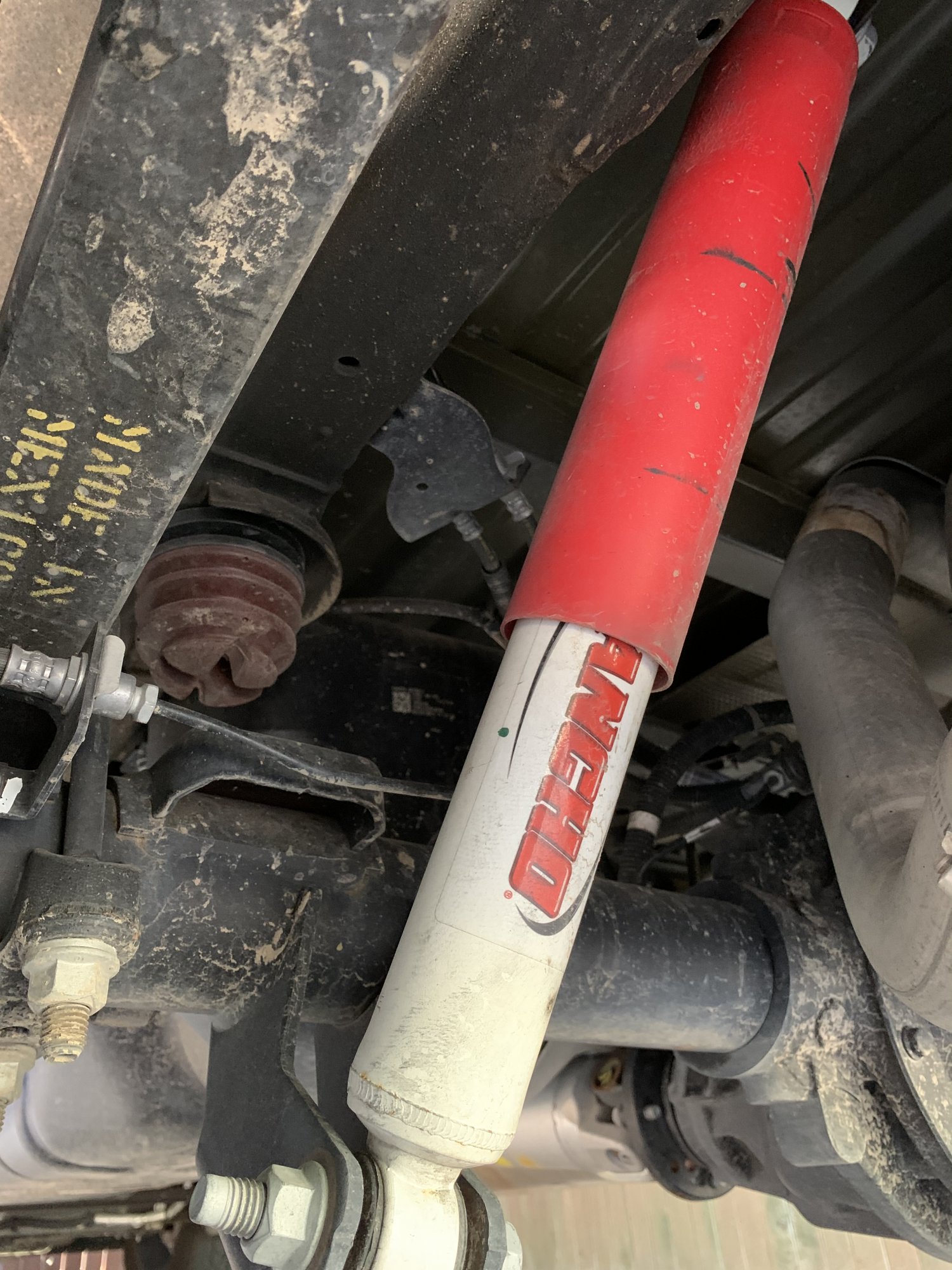

Does this shock look like it’s “weeping” or leaking to y’all?

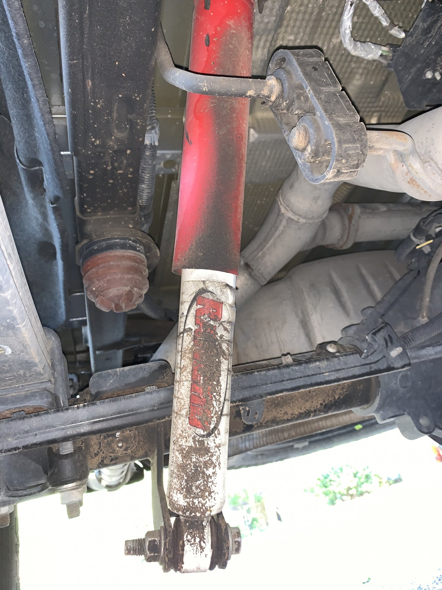

I’m crossing my fingers that it’s shot. The driver’s side shock isn’t wet or dirty at all. This would help explain how my rear end feels even looser than normal, which was already no bueno. 10B57B62-6747-4E21-80D7-6F1E31060E20.thumb.jpeg.6ee35771edef7a21f06c3627168c585d.jpeg

My truck has 12K miles on it, btw. This is how the driver’s side rear looks...

Hard to say if that is oil or it's just in a direct path of water/mud/dirt while you are driving. That shock is on the front half of the rear axle and the other side isn't.
I would clean it up super good and check back on it in 500 miles or something. If there is a film on the surface again, it's probably the oil seeping out.

It’s definitely oil of some kind. I felt it. And you can see the “Rancho” label is peeling off as well. Water wouldn’t do that.
I’m going to have my dealer look at it next time I’m in, but just wanted to see if anyone else has had this happen. I think a few guys have said their Ranchos leaked after the first 10K miles.
Also, my truck hasn’t seen moisture on the road in over 6 weeks, probably. Been pretty dry here in ole Texas. So the shock being wet is clearly some oily liquid.
Wouldn’t surprise me. I didn’t have Ranchos but one of my OEM NHT shocks was leaking after less than 15k. Both went in the trash bin for 5100s, good riddance.
