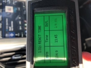

I hooked up my dashhawk, that I’ve had since my TBSS, to my ‘21 Silverado.   A dashhawk is basically just a sensor and code reader.  It was handy to measure intake air temp, timing, coolant temp, torque ****** or what ever you wanted when I had my TBSS.  Well it works in my 21, so I decided to check out intake air temps. Compared to my ‘15 and ‘18 Silverado and even my TBSS, it appears the ‘21 Silverado set up works pretty good. I plugged it in after the truck had been sitting for an hour or so and the iat was 81*, ambient temp was 63*.  I started the truck, drove down the road and in about a half a mile of driving 35-40 mph the iat had dropped to 66*.  With fairly steady driving at slower speeds the iat stays within a few degrees of ambient temp.  In stop and go traffic the iat never got 10* over ambient, usually staying 5*-7*. At a steady 55-60 mph drive the iat and ambient would be the same at times and the iat never got more than a couple degrees over ambient.  So I’m not gonna spend any money on any gm or aftermarket “cold air intake”.
A dashhawk can also measure performance based on vehicle speed sensors using distance traveled and time.  I was amazed at how quick this truck ran in the 1/4 mile.

I'm not gonna argue the point.  I'm curious how your truck runs.  What does in the 1/4 mile and what device are you using.  No arguing.  Thanks.
