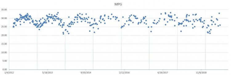

I know you like data. Here's 370 tanks of gasoline charted over 7+ years in my old beater. Lifetime average economy of 28.47 mpg.
If the 1.7% is all of the difference, it should only vary about 0.5 mpg from winter to summer. but I can see a seasonal trend that looks more like 5 mpg difference.
Now don't think that can all be attributed to idling time: No remote start and I parked in an attached garage for all but 1 winter, so I rarely let it warm up for more than 30 seconds before driving. And majority of trips are probably 100 miles average, since most driving was for work. So winter warm up idlling time was only a tiny fraction of fuel usage.
I'm curious what you think of this data.

2 hours ago, aseibel said:
Grumpy, what are some of the other reasons that summer gas mileage is better?
I think it looks just like mine :) Good job sir!
Biggest drag on winter mpg is....ready for this? Viscous drag. In the summer, even on a cool night (shift workers) the 'initial' viscosity of motor oil is maybe 60-70 cSt. On an average winter day more like 5,000 cSt. You've seen this and know it well. Oil poured at room temperature v from the freezer. Now think what this is like for wheel bearing grease. Diff fluid, transmission fluid. Much of these fluids are surrounded in metal it also has to heat to operating temperature. Just over all larger temperature differences. Once fully to temperature the running viscosity is more in the range of 5 to 10 cSt. In the summer you can get it down to 3 to 5 cSt.
Add to this that the fuel maps for lower AIT's are quite a bit richer. Winter air is denser. Tire pressures get away from people in a hurry running 3 to 5 psi low for weeks at at time. And yes, some remote starts. People tend to make their trips shorter which results in allot more cold starts and motors never reaching full heat. For some never.
Then there is also things like snow, water, slush and ice. All use more fuel than dry hot pavement. Did I miss anything?

Is there a difference? Yes but not one that is statistically different enough to make you notice. Thus the 1.7% comment.
