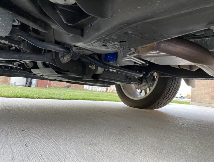

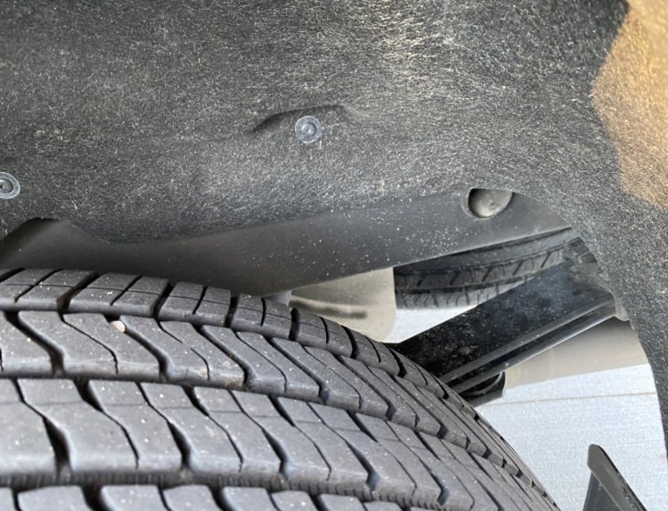

Morning.  I leased a 2019 Silverado and have been driving it for about a year. . The plan was to buy it out of the lease early and lift it.  I had an appointment set up to meet with the dealer for purchase, put a lift on order, had some LED taillights come in too and when I got under the truck to run their wiring harnesses, I couldn't believe how much rust was already on the truck. After looking around online it sounds like this is pretty common on GM trucks due to the wax coating that they use to dip the frame. Now I'm at the the point where I'm considering scraping the project and just getting a Ford or RAM next year when the lease is up.  Of course you may get some rust on an F150 or RAM too but I can't imagine it would be to this degree already.  In fact I've searched online for issues with other two manufacturers and have only found reoccurring posts on the 2019+ GM trucks.
My question is, is this no big deal and something I should just treat with Krown once a year and forget about it, or is this a real cause for concern? Only two photos are included but the entire underside looks like this.

Yea the road salt will do it but, it will do the same to other brands.
In Wisconsin, your frame would look like that the day you drove it off the lot. I'm actually jealous of how little rust you have.
You can spend time cleaning it, applying oil, nox or whatever. At the end of the day, I believe the frame will outlast the rest of the truck.
It's surface rust, Just drive it. You will grow tired of your ride first, or some major electronics failure will turn your truck into worthless scrap before the frame rusts out.

Take it to the dealer and talk to them. I had my 2012 Silverado frame wax re done under a TSB. Then I undercoated the truck, like I've done all of my trucks. Never had a problem afterwards. But you have to re-apply the undercoating every year.
A quick google of both brands using 2019 or 2018 F150 and rust reveals threads about the same thing, so not sure why you aren't finding the same thing. It is surface rust and won't cause any issues other maybe making some bolts harder to get off down the road, no brand is immune to it and you will have similar rust on the others. If you like it, buy it and enjoy it. As with anything a little maintenance goes along way from cleaning to lubing and protecting. You should be spraying it off on occasion and if you see fit applying some protectant, same would have to be on the other brands. For what it is worth and all the supposedly negative views about the wax coating, for all the decades they have used it GM hasn't been known to have any frame failures from. Dunking it in wax coats every single nook and cranny both internally and externally, same can't be said for painting...
