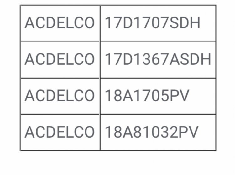

i did police brake rotors and performance police ceramic pads for my 2016 silverado.
quoted from description of the pads
"ACDelco Gold Enhanced Performance Severe Duty Ceramic Brake Pads"
"These brake pads are specifically designed to meet the demands of police and fleet vehicles."
-rockauto, just entered in my truck specs as i didnt want fitment issues, especially since GM offers police packages for silverados now.
-you dont need the "tahoe" police brakes, the part numbers are different, not sure on the actual difference though, the pads i ordered are the ceramic performance pads. they are not beveled at the edges, i have full pad contact on the rotor, like the tahoe brakes.
-i didnt want semi or metallic due to noise potential, OEM brakes are cermaic.
-copy pasted from my order receipt.
ACDELCO
17D1707SDH
ACDELCO
17D1367ASDH
ACDELCO
18A1705PV
ACDELCO
18A81032PV
figured id share, as i did a fair bit if research because i couldnt easily find info prior to my brake job.
