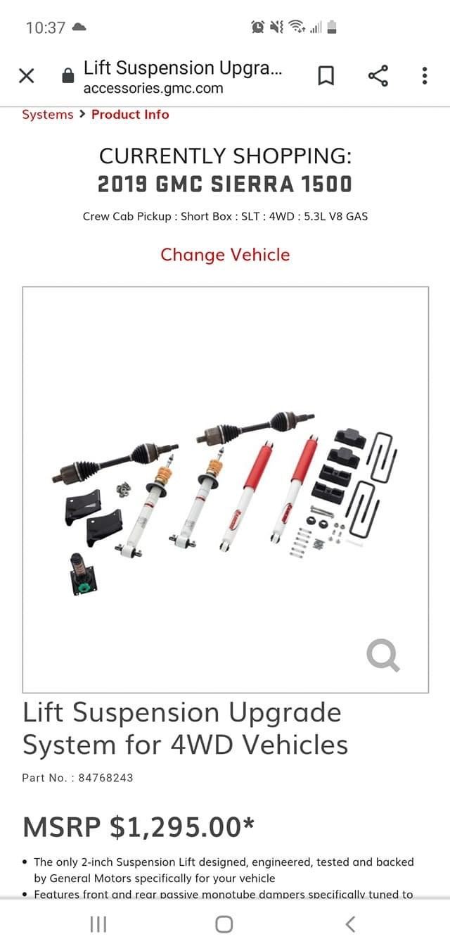

You have a denali correct?  I have a AT4 and looking at swapping the suspension out to lower it to a regular sierra/denali height to make it easier to get in and out with my back injury. Been struggling with what all i have to replace. Fro my understanding if i went with the 5100’s, ill have to remove the blocks and run shorter ubolts for the rear and replace the front axle.
I have a LTZ. I would think you would just have to install the front 5100s at the highest setting and then remove the rear blocks and ubolts and you should be good to go. This would leave you leveled out. If you want to stock height you'd install the front 5100s at its lowest setting and not sure about the front axle with this set up.
Shows axles in the factory lift kit package so im assuming if you go to normal height ill need to swap them out. The way i been the last couple days i might have to go even lower. Went to physio today and i could barely get in and out of the truck. Shouldnt have even been driving but had no choice.

Just make sure you order the correct 5100's. There is a part number specific to the AT4 which is a longer shock.
I replaced the Rancho's with 5100's in mine. I took out the factory 2" block in the back and put in a 1". I had the front shocks set at +1.1" and now the truck sits nice and level. No axle replacement required.
I been seeing that. Hard to find any kits made for the 2019+ sierra non at4. Does the bilstein shocks get rid of the bouncing feeling in the rear when you go over a bump?  It literally feels like the ass end of the truck bounces up and lands side ways
