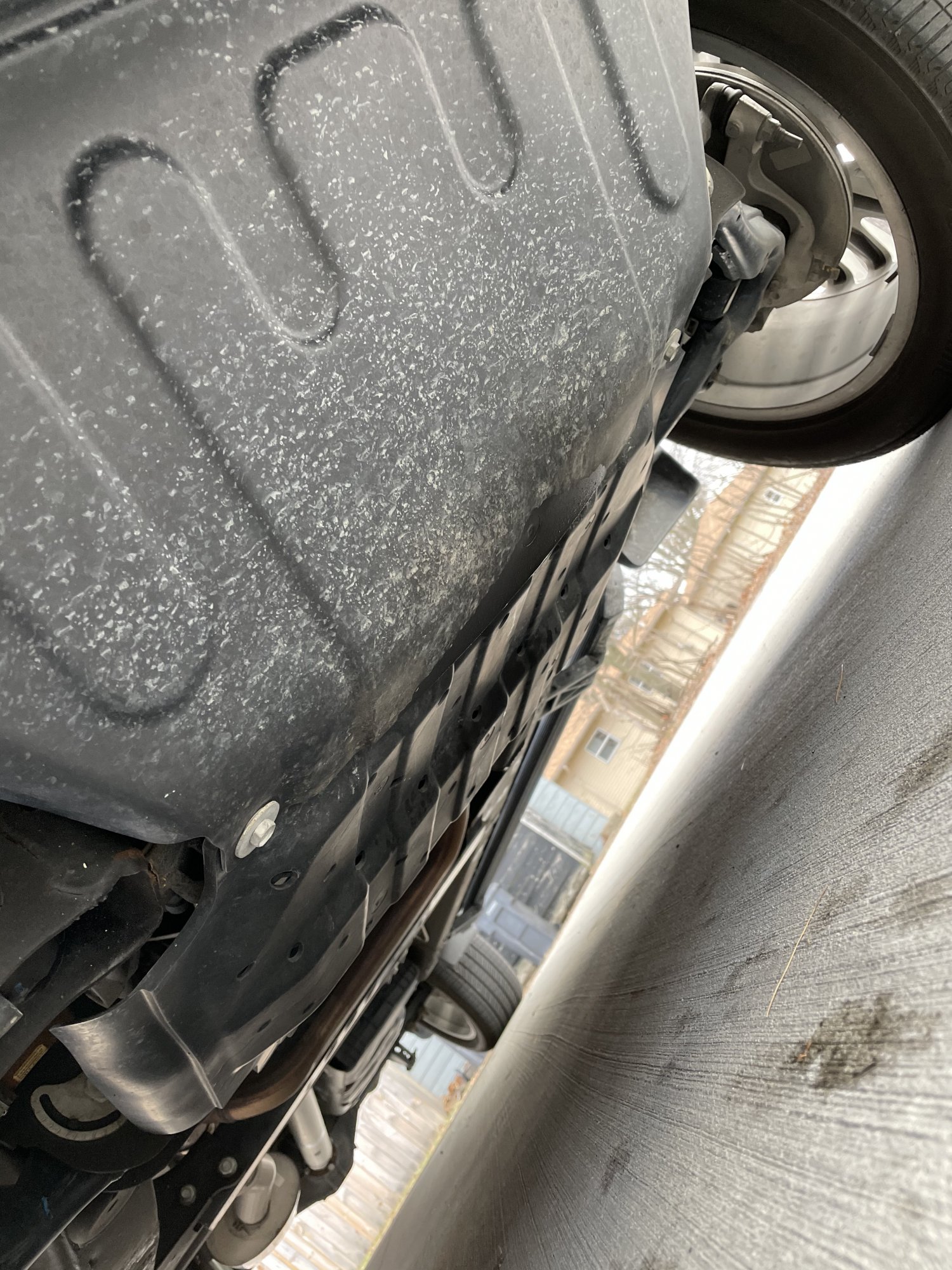

Just had the dealer change the oil, filters, rotate tires couple weeks ago and notice a spot on the driveway. I thought it might have been a work truck from Plumbers coming over working on some main line issues. But yesterday noticed more spots and just looked underneath. Here is what I found.
It's a CPO truck I bought last May and already this. My first pickup truck too. Taking it to the dealership tomorrow at 10am. Told them they better have another truck for me to get around to work.

Oil filter leaking?
That is what I'm thinking. Seems to be right there maybe. Not first time I've had oil service done when the filter was not tightened properly(not this vehicle).

They could just have been really sloppy when they changed the oil.
They may just be lazy and are trying to work around the skid plates, making a big mess as they go.

When my oil cooler lines went bye-bye, it was dripping off that same skid plate up front. Really no good reason for oil to be that far forward from an oil change.

It was my oil cooler line they found out. Ordering the part and I should have the truck back in the shop on Tuesday. Service advisor said he's seen a few of those happen already.

It’s happened a lot on these new trucks, sometimes catastrophically.
Dealer tried to make me wait a week before they could look at it. I convinced them to take it the same day over concerns that it would get worse. Wasn’t going to be driving around a time bomb for a week. Although maybe I should have just let the engine go and handed GM the huge bill. ?
I’ve looked through some of the 22 page thread about about this problems with guys blowing oil all over hwy and left to be towed. Maybe some seized motors too.

Best plan might be to find out where the oil is coming from before deciding major surgery is necessary.
