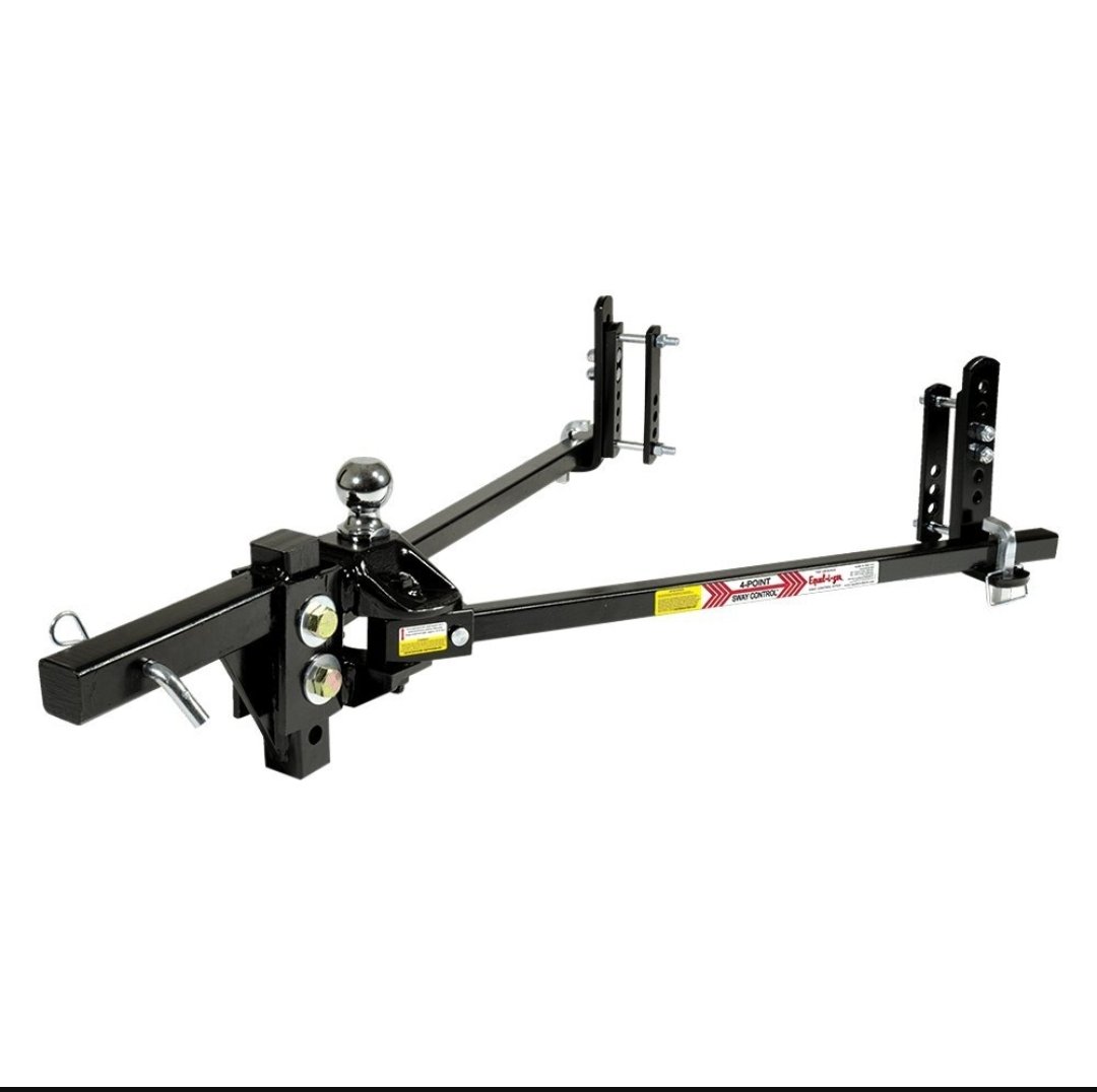

What kind of WDH are you using ?
Does it have chains on the bars and a hook on each side of the tongue?
By tightening up I mean using the links on the chain.
This is the kind of hitch I'm talking about8c5121814151fc758ffde3370e961459.jpg
Sent from my Pixel 3 using Tapatalk
This is the one I have. It has spring bars that attach to "L" brackets on side of trailer frame. I could move the "L" brackets up one or 2 more holes but as of right now, I need to raise the trailer jack almost up to swing the bars into the brackets. Like I mentioned, the directions say as long as the front wheel well returned to pre hitch height, they call it good. And my front wheel well is perfect. But if I wasn't leveled in front and still had the rake, with the 2" sag in rear,  once front wheel well was adjusted, it would be level. I know I could probably just put a block on rear axle to raise it up, but then I would have a rake again. With air bags I would have some options. I prefer the leveled stance but may have to make that decision soon.
