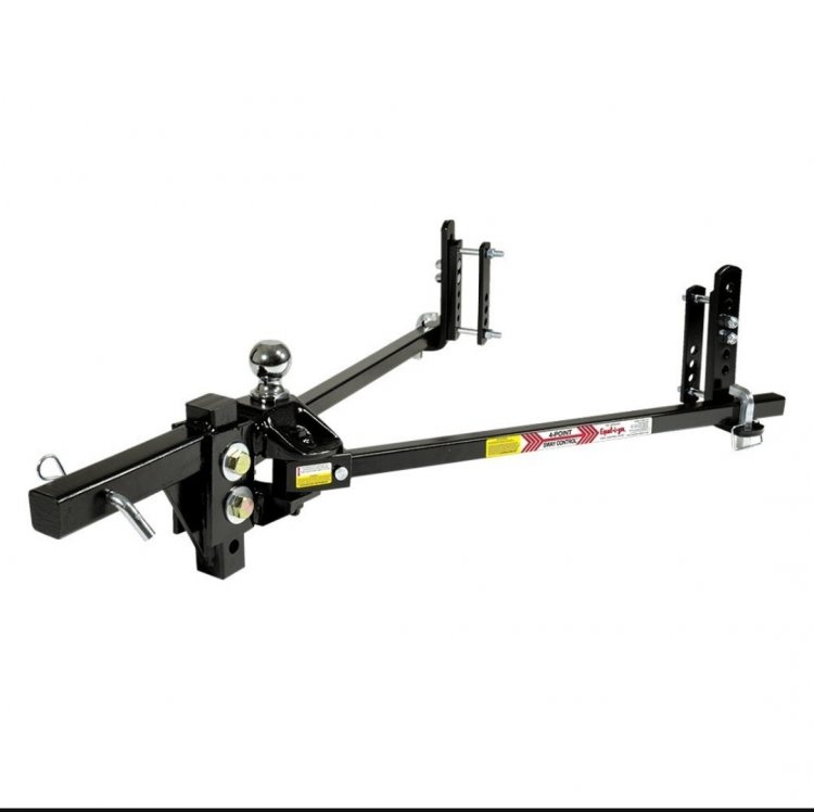

So I decided to also reach out to Equal-Izer to get their thoughts. When describing what is happening, I was told to go through the adjustment process again and that I needed more weight going to front axle. That would seem like the logical answer. But then on my next response, I sent a copy of the CAT scale ticket and their response on that was that I am within the specifications which I pretty much figured and others here have agreed with. I then asked for their thoughts to eliminate or at least reduce the sag. I mentioned the Air Lift bags I have. I am waiting to see what their response will be and will update when I get it. I am just guessing but I think it will probably agree with other responses on here that it is probably going to help.
I apologize and it may seem to a few that I'm not listening to your responses because I tend to experience a bit of OCD and try to get as much confirmation before I do stuff like this. But I'm pretty confident that this is going to get solved.
Ok, now I have confirmation from Equal-izer. Here is their response:
The hitch isn't designed to take out all of the sag in the rear end. 2" of sag is totally normal and acceptable. Do get rid of the sag beyond that you would get air bags.
So now I know the next step...
