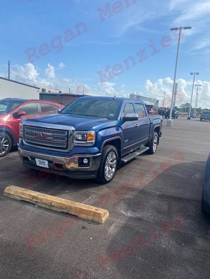

Now that I just recently purchased a 2015 GMC Sierra Crew Cab with a 5.3, I hope I can help and entertain others with what I have in mind. I bought this truck in August 2021 with 112K miles from Gay GMC dealership in Dickinson, TX. I drove about 2 hours away to purchase due to it being so clean. This truck has never towed a trailer and was a daily driver for a 65 year young man. The man didn't plan on trading it in. He took it in for routine maintenance, tires and brakes. He received a 2021 sierra as a rental and ended up buying it. Anyhow, that's the story behind "Old Bue"

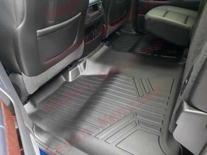

I love floor mats. That's always one of my fist things to upgrade. What do y'all think?
Edited by Regan Menzies

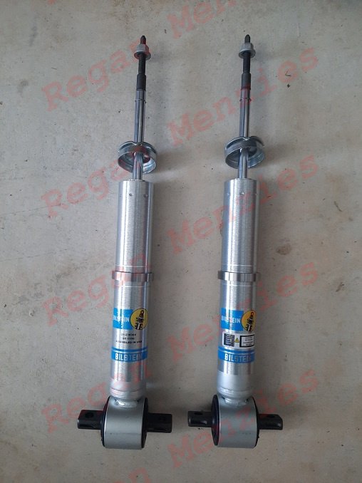

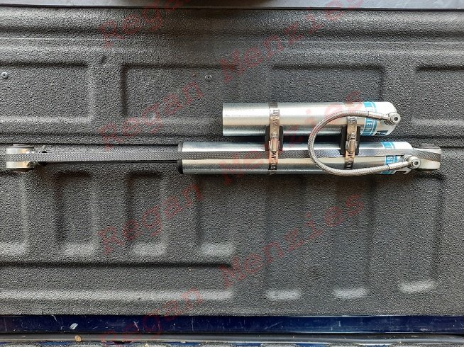

Waited a month for these to come in. 5100's for the front and 5160's for the rear. I'll be installing these this weekend.
