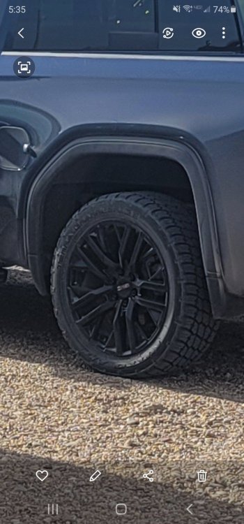

Take a look at the Nitto Terra Grapplers G2's. Certain sizes are 3peak rated. Don't know which ones are, but the 285/45r 22's aren't, that I run.. The tread doesn't change, so I have no idea why. Since the tread doesn't change for the 3peak rating, I said it was close enough.
I was a KO2 fan boy, until they didn't make a 22" tire. I went with the G2's and couldn't be happier. Central Nebraska isn't Colorado, but we get snow. Excellent on the highway. OEM's were a joke on a farm truck.

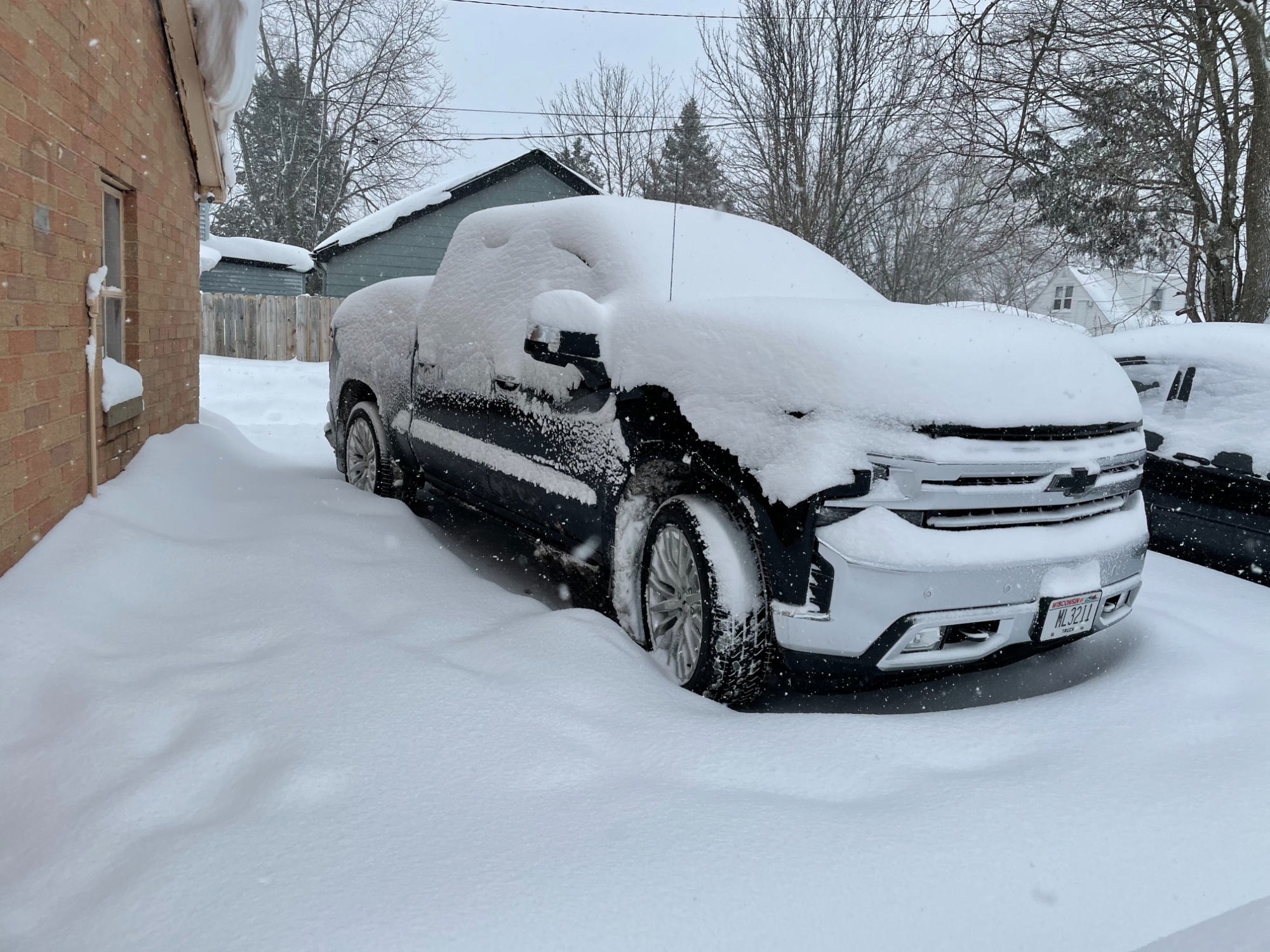

Only time I have been stuck in the snow with the factory Bridgestone's is when I managed to high center myself on the assist steps.
They do fine if you remember, you are driving on a frozen surface with snow on top of it.
