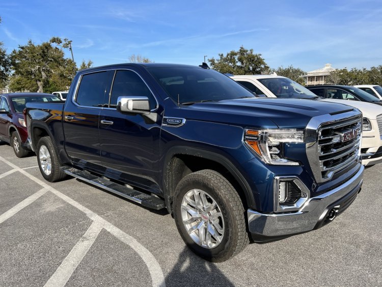

I installed some Kenda Klever AT2s.20211108_170417.thumb.jpg.74d2e955fcc9db8e580c76b5744b691a.jpg

Looks good. Did you go with stage 1 or stage 2? How was the installation if you did it yourself?
