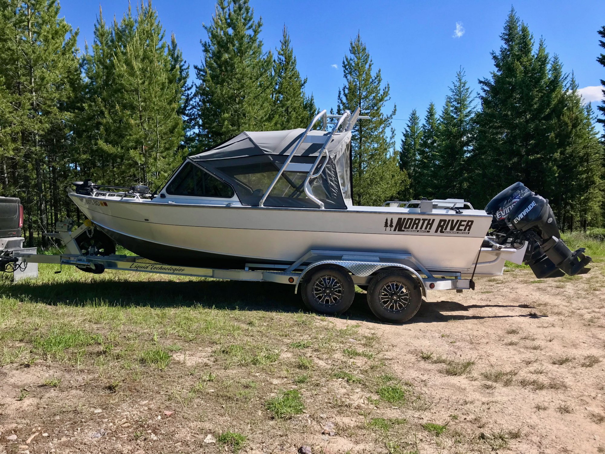

OP, I had a custom welded aluminum boat trailer built last year. My AT4 wouldn't actuate the EOH brakes.
After much pulling of hair (that is a diminishing asset) I found that some truck's don't play well with some
brake systems. Once I added an HBA-CAM to my boat trailer all things worked as they should.
If you have electric only brakes than this may be of no use to you.
