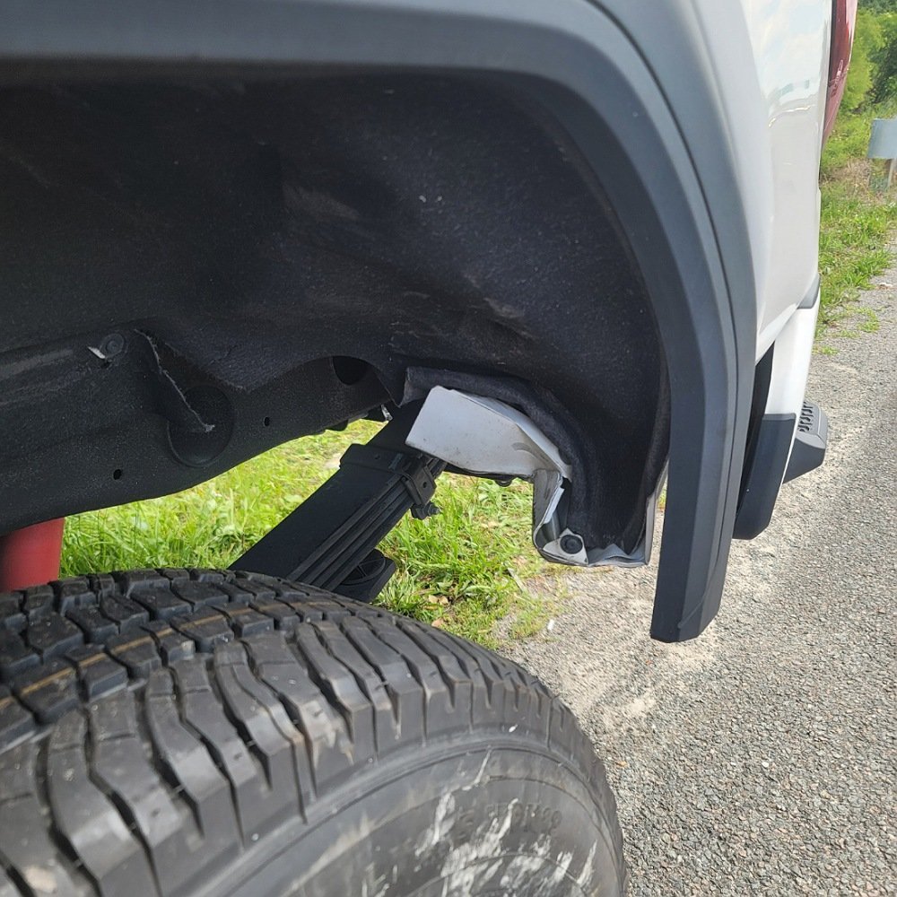

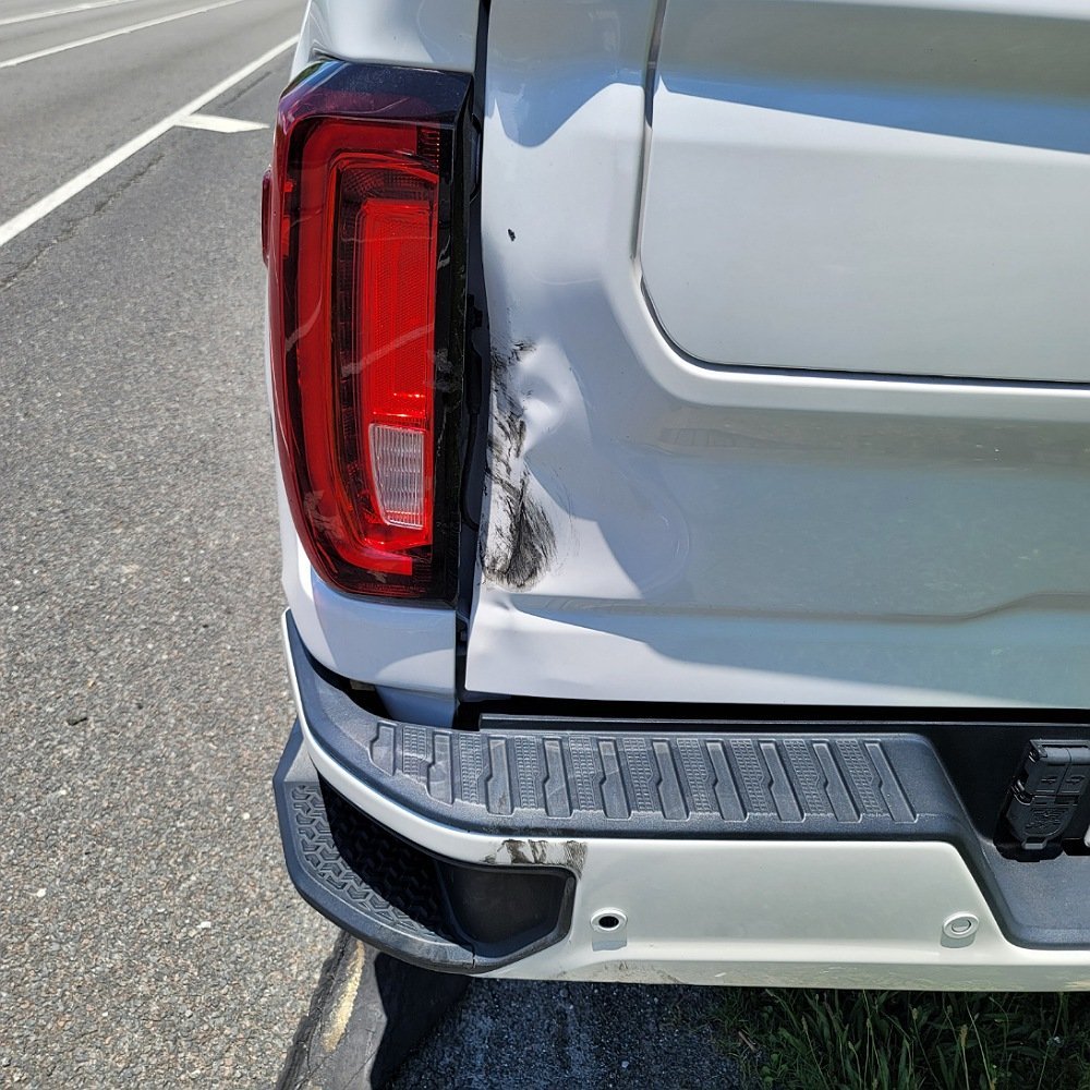

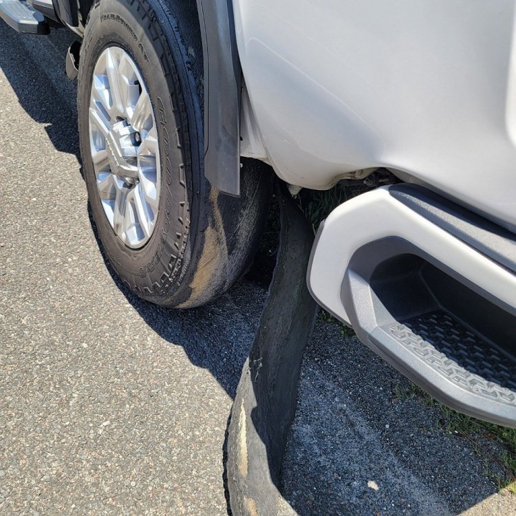

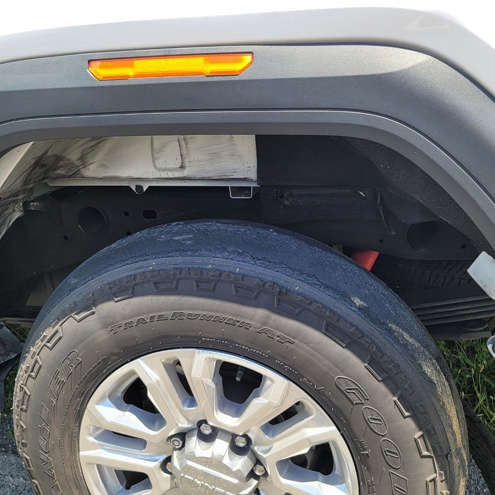

So I was just driving along this afternoon and had the worst tire blowout I have ever seen. My rear left panel and tailgate are wrecked.
Backround, always rotated tires.. TPMS all normal, 43K On stock tires, no lifts or mods.
Anyone seen this or know what to do?

Nothing you can do really. They make hundreds of thousands of Goodyear tires every year, so the failure rate is small but can happen. Just look at all the blow outs of the side of the road from semi trucks. It can be a newish tire and all of the sudden something happens that upsets the structure of the tire and BAM. A minor tear in the lining, bad belt from the manufacturing process is all it takes when there is 80psi or 100+ psi in the tire.
You're tire didn't really even blow out though as it's still holding air, just the tread cap de-laminated which could be a manufacture defect that took a long time finally give out. Goodyear won't help you here, neither would a dealership so you'll need to contact your insurance company for this.
I had the same thing happen to a tire that had a slow leak and felt like it had thrown a weight. it actually blew out though with 80psi and over a ton in the bed it seperated the side of the bed from the floor and scared the dickens out of me. I'm surprised you didn't have a vibration before it came apart
Gotcha... Thanks guys. Yea, was holding 80psi and didn't have a vibration for about 10 minutes, pulled over and inspected everything and didn't have anything stand out..... Wasn't hauling, so definitely it just caught me off guard and figured I'd check here...
Going though insurance now, sucks but oh well... Going back to Nitto tires.

Looks like tread separation versus a road hazard.  Probably caused by dry rot.  Tires in Florida generally speaking have a maximum life of about 4 years regardless of miles.
