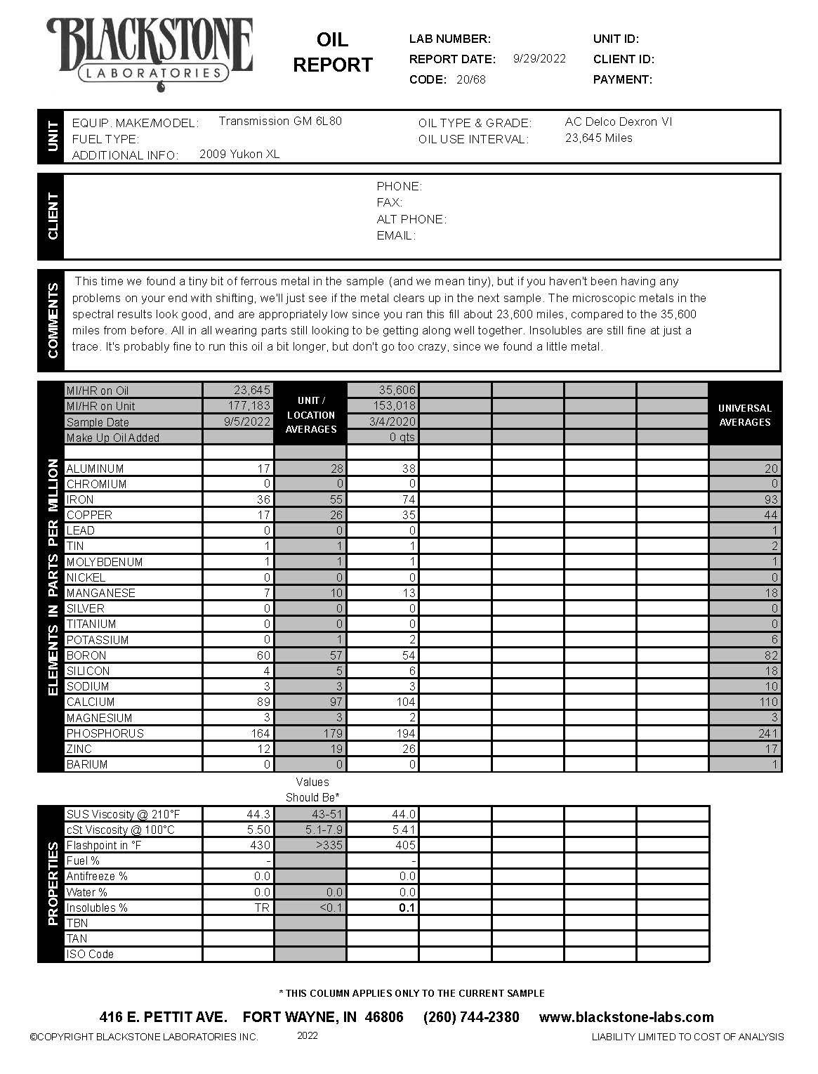

Good report, here are two of mine for comparison.  ACDelco Dexron VI only seems to last for about 40K miles.

Ah, OK.  Shows how much "meat is left on the bone" sucking fluid out vs. a full drain.  3.5 quarts is only about 25% of the total fluid capacity.  I was on the fence about pulling the pan to change the filter this time, but figured I'd wait for the UOA to come back.  I'm glad I did; the filter can wait a while.  For the next several 10s of thousands of miles, I'll simply remove the drain plug and let'er go.  Pour in 6-6.5 quarts via the dipstick tube and drive away, couldn't be easier or quicker.  Much easier than my BMW which has a fill hole requiring pumping in fluid with the engine running above me while watching fluid temps on the scan tool (filling temp is 50* C colder than operating temp on that one) or my wife's old VW which didn't have a fill hole, only a drain hole, requiring filling via the drain.

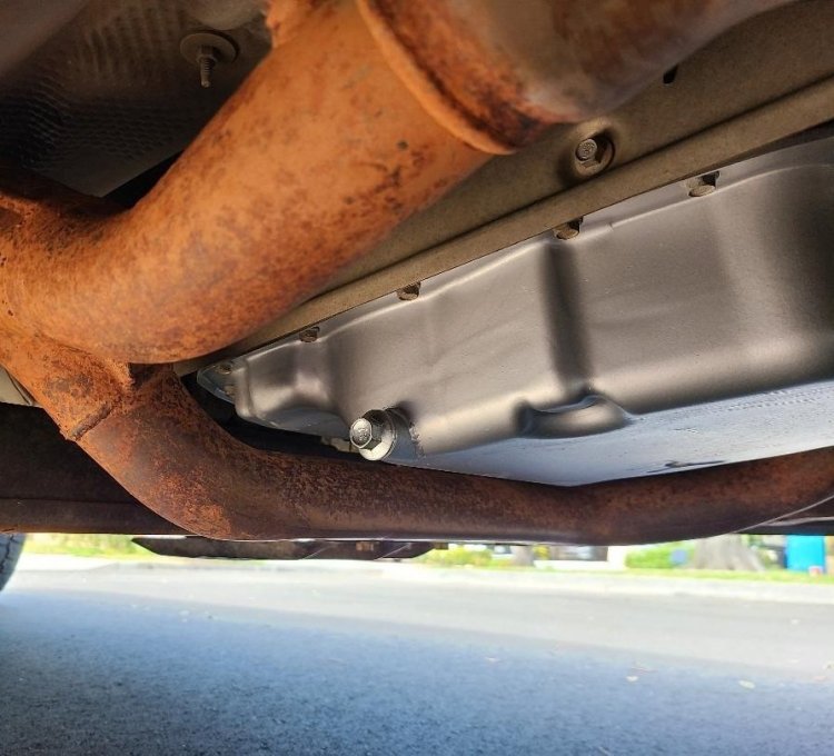

1865432247_GMCtranscrop.thumb.jpg.f8fb3fbb2ae26ddb4b82456da98bdea6.jpgYou have a drain plug?  I had to install my own.
