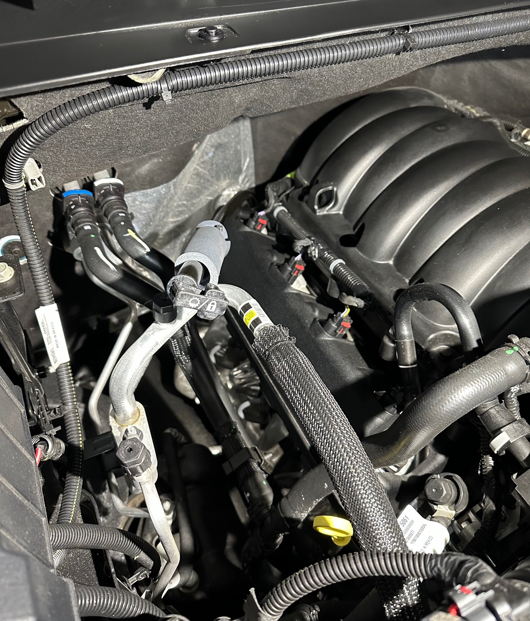

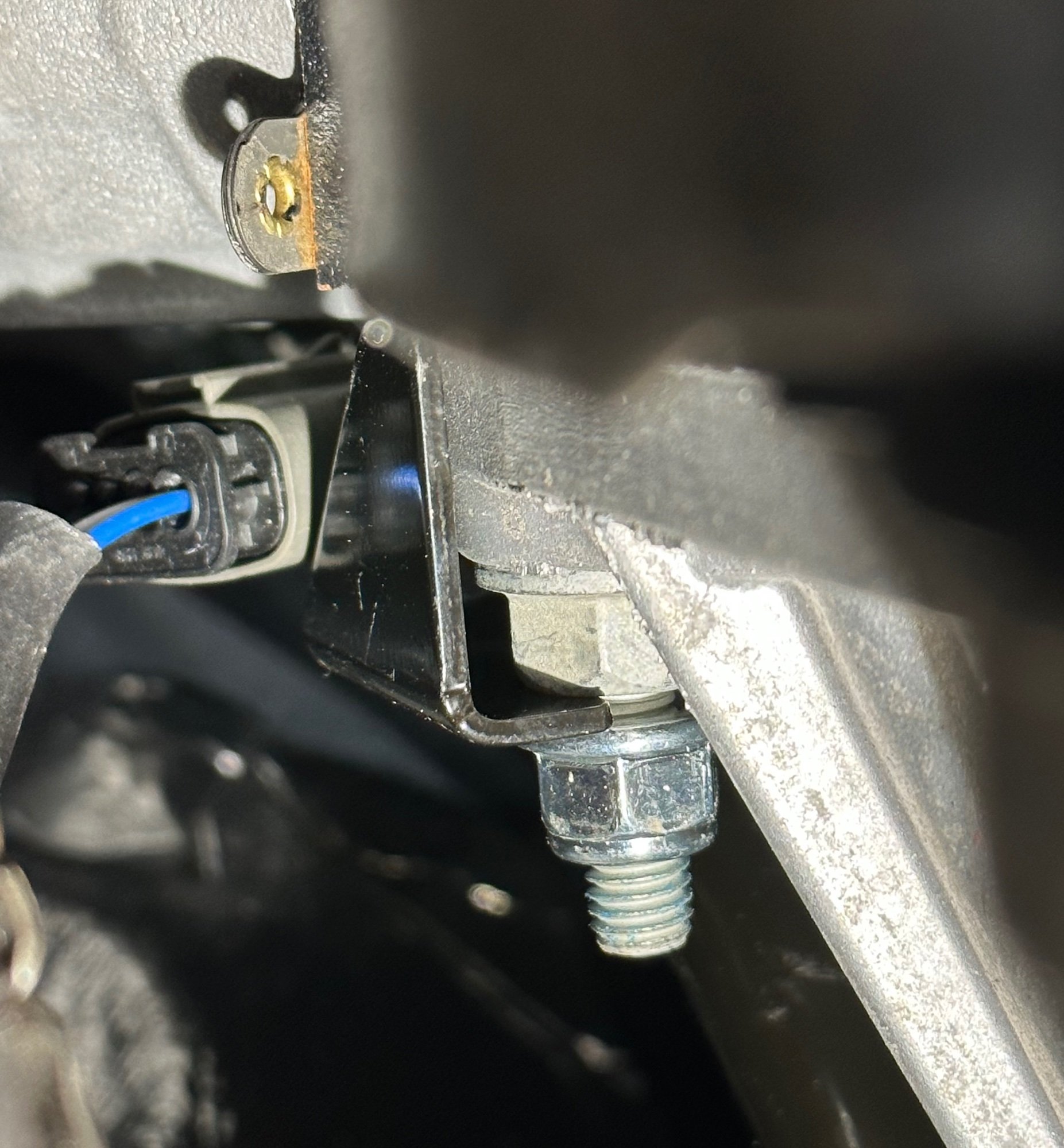

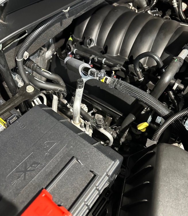

Okay so I installed mine this evening.
I’m glad I did this on a perfectly clean truck vs trying to do this with a bunch of dirt and mud etc.
it sure is tight quarters reaching up to put the flange nut on up between the cat and trans.
this thing sure does stick out into the engine bay. I took a few pics, but it appears the others who shared pics are in the same spot. Only goes one way.

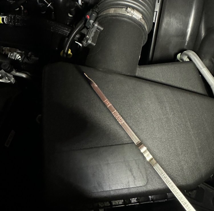

Do you guys find the dipstick sure takes some fanagling to get it down the crazy S shaped bends.
my truck was bone cold and it appears the fluid level is way up on the dipstick past the full hot. The cold is way lower.
what did you guys experience? I will check after a drive tomorrow.
Edited by Pryme
Your right about it being hard to reinsert. I wondered if it might get a little easier as time went on but I ended up selling my truck in February so I wont know if it does.
On this truck the only time to check it accurately is at full temp when the cooler thermostat opens. On a stock truck its 194 but if one of the bypass kits is installed the reading should be accurate at any temp with the truck running.
I made note of my reading at a cold non running state just for service reference to get a baseline after a pan drop.
