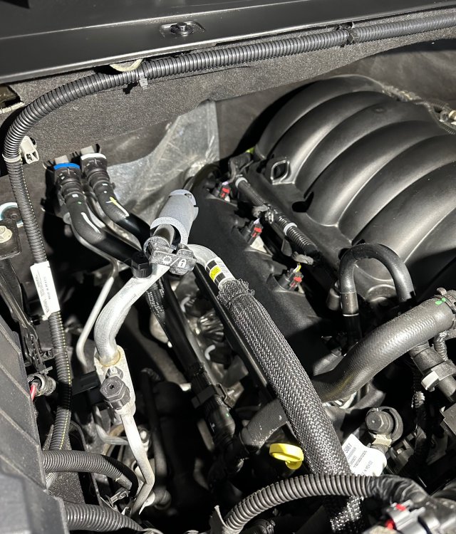

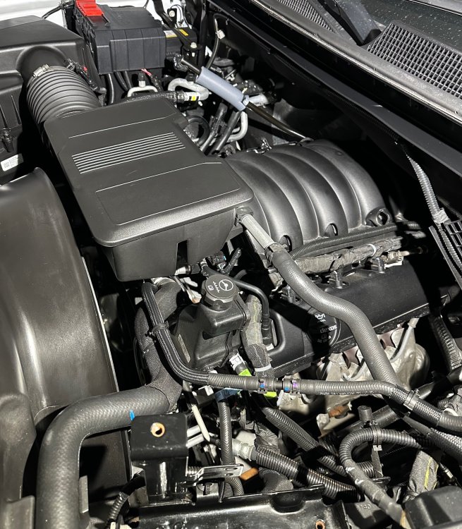

I just want to say to the OP, Epsilon Plus thank you for your concise instructions and part numbers. I was able to install my dipstick in less than 30 mins.
I originally was looking into this because my transmission was clunking on downshift in my 2020 Silverado 2500 HD WT with a 6L-90.  I  use it to tow a fairly light 5th wheel and only have 16k miles on it. With so few miles, I wasn’t interested in a pan drop and filter replacement so soon. Adding the dipstick allowed me to suck out about 50% of the old fluid (5qts) and add some fancy cherry flavored juice from Amsoil.
No more clunking and now shifts like butter. Thank you - Mike

I tried installing a dipstick on my ‘19 1500 and no way … Tried and tried…Thought I had it coming from the bottom but still no go. I wonder if the HD models have just a touch more clearance between the cyl head and firewall?? B
