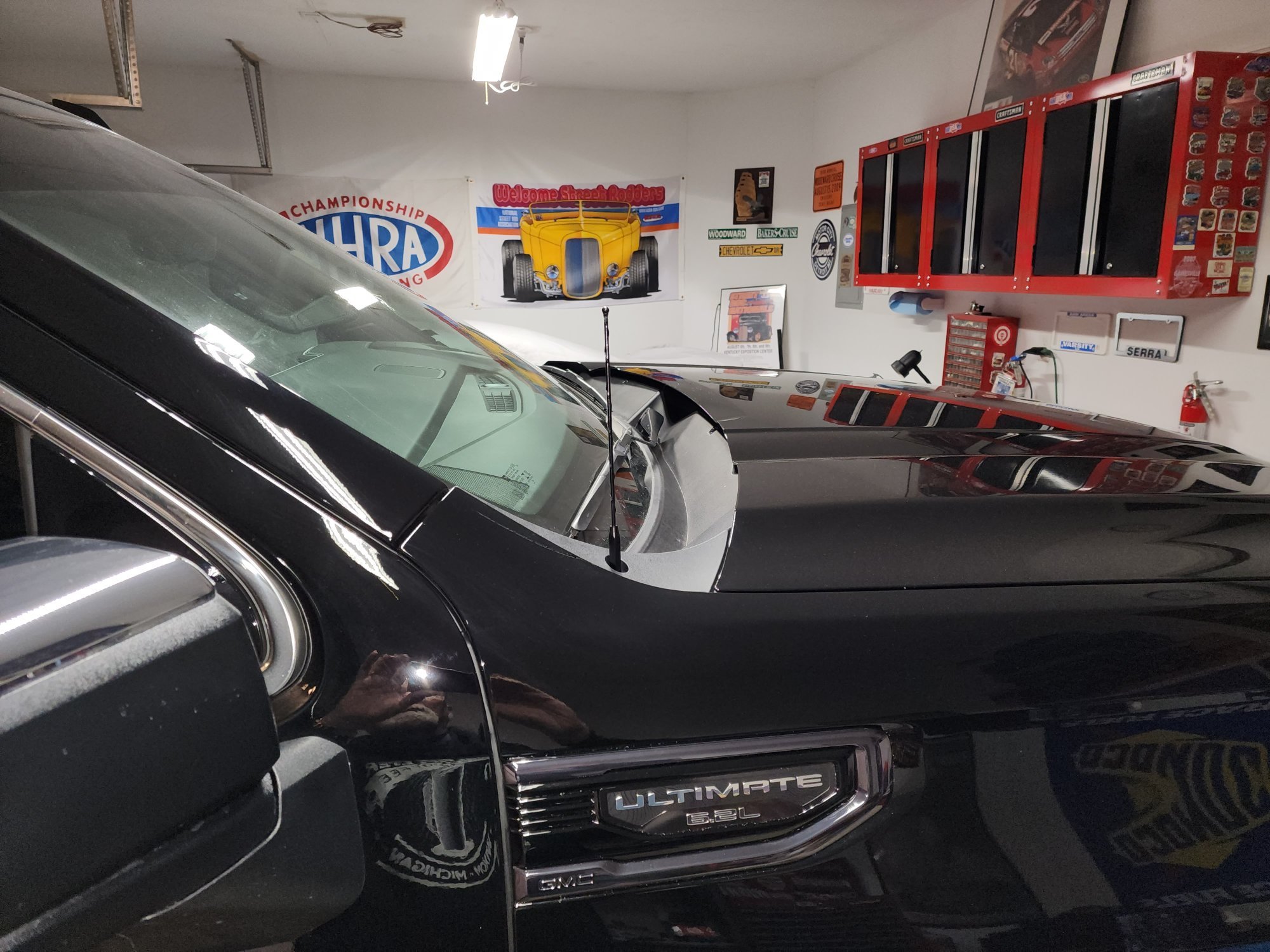

So GMC puts a giant radio antenna on the truck like Ford. I ordered a shorty from American Trucks and it arrived this week. No good. It wouldn't fit the stud. Decided to just make my own. I cut down the OEM antenna to about 9". I heated the ball on the top and used vicegrips to pull it off. I needed to grind the shorty down in order for the ball to fit. A dab of Gorilla Glue and took a hammer to tighten it down. A quick hit with black paint and done. Total time was about 15 minutes. Let the paint dry and glue set up for a couple hours indoors and that was it. Local FM is fine. 20230202_181650.thumb.jpg.1c7d47b9495170e5a5427d3cbbf54b30.jpg
