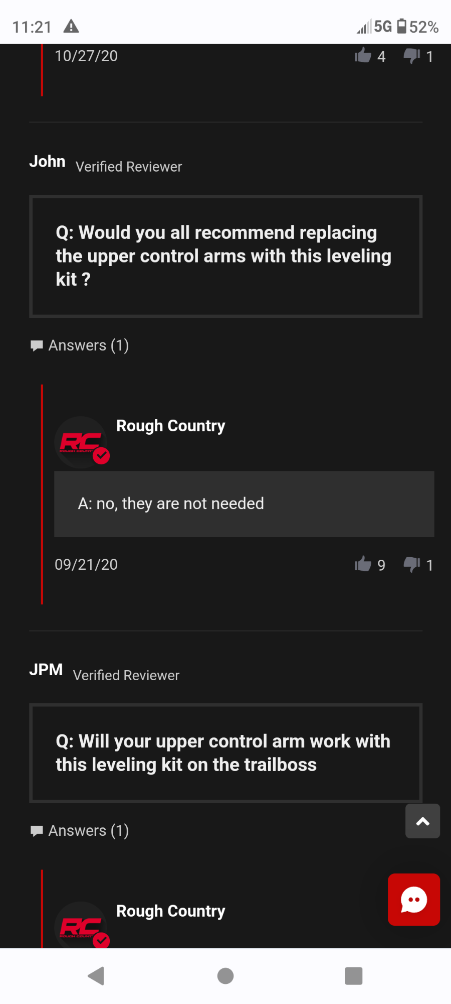

1.5" TB Leveling kit without changing the UCA's. That's 3.5" of total lift using the same UCA's.
https://www.roughcountry.com/gmc-leveling-lift-kit-1319.html?utm_source=google&utm_medium=cpcs&utm_campaign=18887230045|&utm_content=&utm_term=||m||fit_first_1321-a&gclid=CjwKCAiAu5agBhBzEiwAdiR5tKM31DB-8iWaZ5pjqaDw24rIilVllmICLfokEglUEl8bBVsdebvckBoCapoQAvD_BwE

So, we should listen to you instead of Rough Country, who is literally in the business of lift kits. Ok, got it.
Guys level out there TB's all the time without changing the UCA's and don't have any problems. GM anticipated this and built enough geometry into the UCA's to handle it. Just look under a stock TB and look how the control arms are sitting, just about level, no extreme angles. These are a new generation of chassis and suspension, it's not the old school stuff where 2" would really be pushing the limits.
