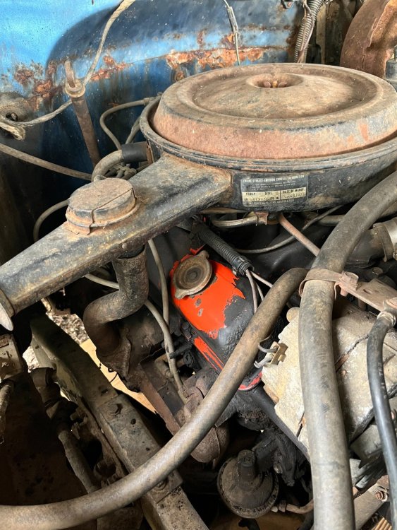

I have a 1976 350 small block c10. I am wondering if it is beneficial to swap out the air cleaner for an aftermarket one. I have OEM thermac model with the snorkel and pre heater tube. Would it be best just to refurbish this one (clean and paint) or would it be better to swap for an aftermarket one. If its better to swap, what steps are needed to eliminate the pre heater tube and manifold outlet?

I would also clean-up and save the original. THEN buy an open element Summit Racing air cleaner with a K&N type full flow filter media. 👍
