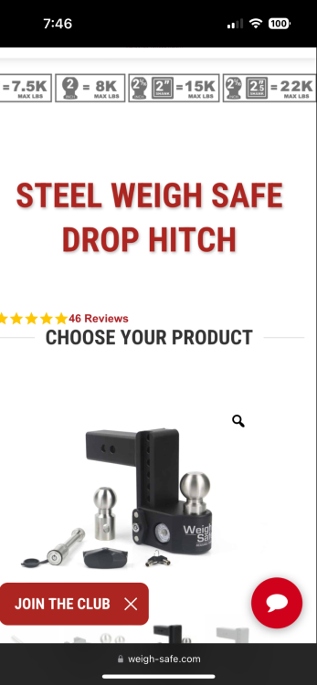

On 12/9/2023 at 6:15 PM, Mike Weinandy said:
Thanks for the reply. The most important thing in looking for is capacity. Do you know what theweight limit is on the bw hitch you have? Would love to not worry about dinging the tailgate.
The weigh safe is 22k. I’m never going to tow that but nice to know it can ha. The gauge is cool too showing tongue weight. It works.
I don’t ever keep it in the receiver when I’m not towing. I have the whole thing in a case until I need to use it. Too expensive even with a lock and don’t feel like it rusting into the receiver.
