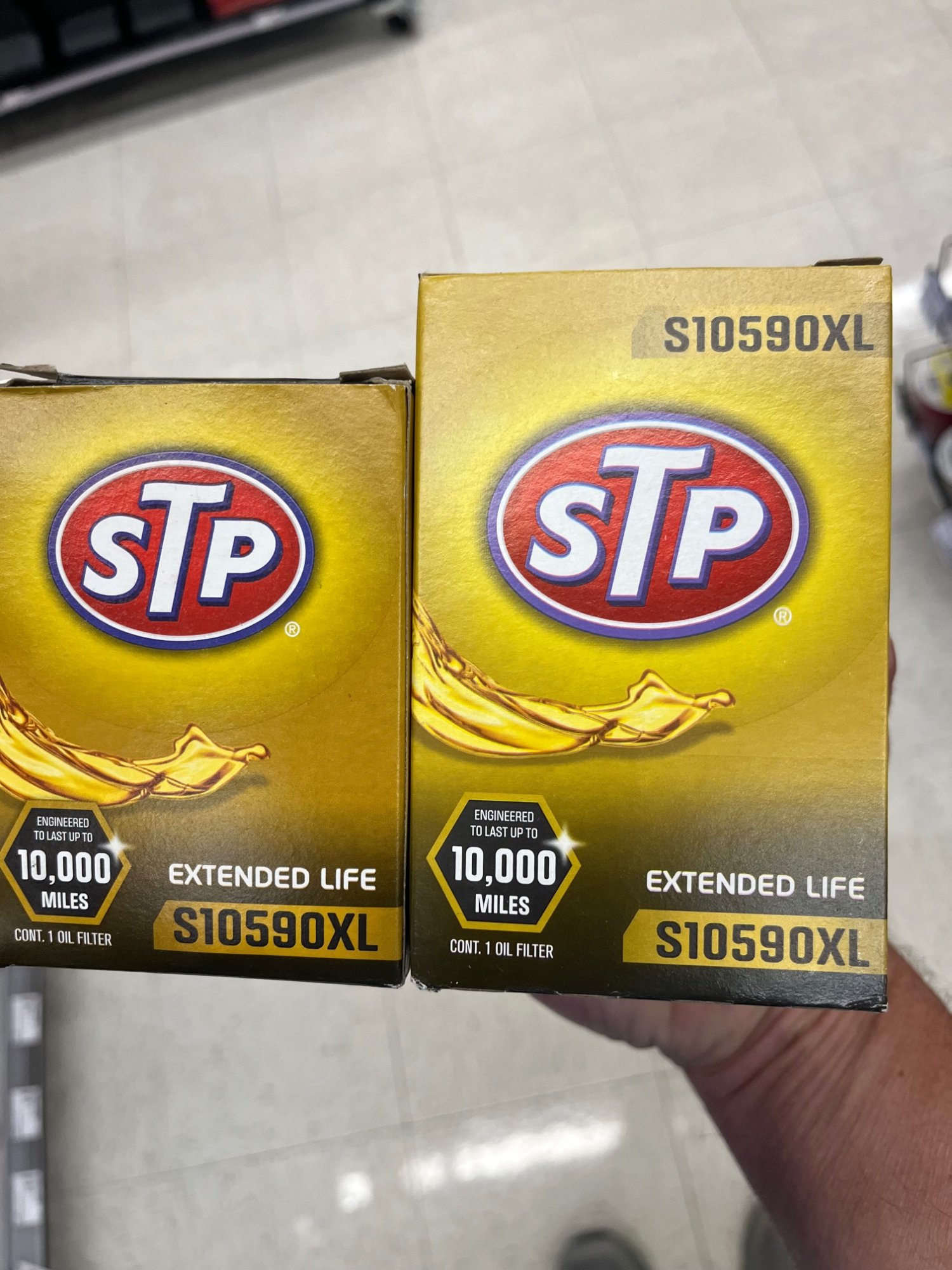

1st oil change. 2023 Sierra 5.3
Decided to change myself instead of taking to the dealership for the free oil change.
Went to purchase Mobile1 Dexos1 oil and filter. Filter type: STP Extended Life part number S10590XL. I noticed they have 2 sizes with the same exact P/N (see pic). One of which is about an inch longer than the other. Removed them from the boxes and sure enough one is longer. Used the cross reference book to check out other brand options. I found quite a mix of long verses short options that all show to fit my 5.3 engine.
I assume the long one is better but want to make certain I have this correct. Of course the parts guy had no idea.
I searched the forum and found some mention of bypass pressure differences which only added to my concerns.
Thank you.

Not sure what the story is on the STP filter. In light of the confusion I would look at a different brand. The AC PF63 is the filter for your truck but youre under no obligation to use an AC filter to maintain your warranty. If youre buying your filter at A-Z youre paying too much. Walmart had a much better selection for less $$. Around here the Chevy dealer sells AC filters for less than Walmart.
Well I just picked up a PF63 at Walmart but the confusion between short and long is mind boggling, especially being the same part numbers. I sent an email to STP requesting clarification.
Perhaps one is a copy of PF26 and the other PF63?
A couple years ago, GM changed the recommendation for several applications from PF26 to PF63.
They indicate that PF63 is preferred but that PF26 is acceptable when PF63 is not available.
The PF63 filter is 3/4 inches (19 mm) narrower than the PF26 filter, but it has a taller pleat height, which maximizes volume efficiency and cold flow performance. (Fig. 7)

I would not use the S10590 or S10590XL filter.  The bypass pressure is too low and set to the original PF48 spec of 12-15psi (same as the PF48).  The PF63 is 22psi.  They bumped this due to the tighter oil passages and oil pump operations.
TSB on PF63 applications - temp.xml (nhtsa.gov)
AC Delco PF63 or UPF63R are the factory filters you can get, Mobil 1 M1-212, Motorcraft FL500S or Wix WL10255 are some good picks also.

Thanks. I went with a PF63 off the shelf at Walmart and will continue to use this filter in the future. How do we know if this is the current PF63? Have the original PF63s been discontinued?
I have revised my above post slightly.  The PF63 is 22psi bypass from day one, my error was stating it was lower initially.  The PF48 which was on the early 3.6 V6 engines was replaced by the PF63 due to the oil pump changes and oil galley changes which required that PSI bump.  The 2014-up V8 truck engines got the PF63 due to their changes as well from the Gen 4 small blocks prior which used the PF48.
All PF63 and proper crossed filters should be good but verify the bypass PSI still.  The three I listed are spec'd at 22psi bypass, from all the data I found on the STP its 15psi unless they haven't updated that information.
STC responded to my email: Now I’m even more confident about not using their product.
my email:
I’m confused About your S10590XL filter. Tried to purchase two of them and realized theres 2 versions with the same exact part number. One is about an inch longer than the other. Please Explain?
Response:
Thank you for contacting STP.  Regarding your inquiry, Kindly note that the Oil Filter is a licensed product by AutoZone. Please contact AutoZone to get further assistance. We have provided their contact information below.
Wow. Glad I went with a legit PF63 instead is dealing with the A..Z BS
